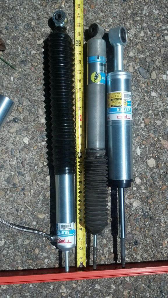

    Thanks man. I have light racing uca's for now, but they should do everything I need them to do.
    It's funny that everyone says the 5160s aren't designed for lifted applications, but as you saw in the pic, they're longer than the 5100s.;)

    #88028
    291
    Westminster, Ca.
    05 PRERUNNER
    TC Upper Arms, ICON coilovers, Camburg spindles, AP standard leaf packs, ICON Resi.'s, AFE intake, Magnaflow Magnapack, Defiant Light Bar with PIAA 580's, 6K HID's top and bottom
    Ya they are longer no doubt maybe for a good 1.5"!
  16. May 11, 2013 at 8:40 PM
    #56
    650H1
    650H1 Well-Known Member
    Jan 3, 2011
    #48689
    8,641
    Michael
    VA
    2020 (Cement) TRD O/R
    You have the OEM replacement 5100's... The other 5100's can handle 3-4" and work with Dakar and AP Leaf packs. So don't icons and kings and walker Evans...

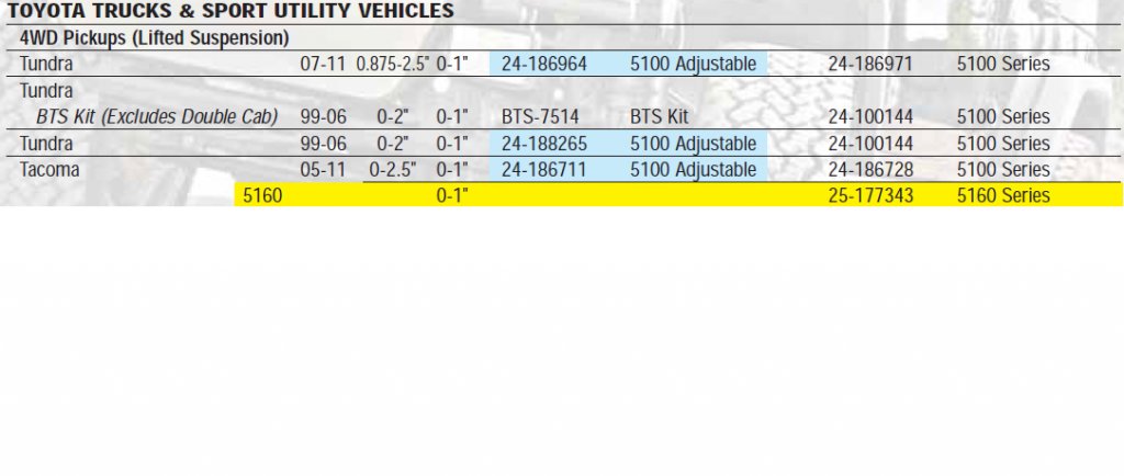

    The toytec ulk comes with the extended length 5100s (supposed to be what I have on the truck), but I bet you're right and I was given the wrong shocks from Toytec

  19. May 12, 2013 at 5:53 AM
    #59
    Brandon###
    Brandon### [OP] Well-Known Member
    Apr 27, 2010
    #36105
    981
    The 3rd column gives the rear lift height. Notice how the 5100 and 5160's are both 0-1", but the pic shows the 5160 significantly longer.
  20. May 12, 2013 at 6:03 AM
    #60
    jandrews
    jandrews Hootin' and Hollerin'
    Jun 7, 2009
    #18122
    16,197
    '09 FourDubDee TRD OR
    A-TRUCK, Fat Kid in the Bed, Custom Pinstriping, Ported and Polished Muffler Bearing, Hi-Performance Bed Mat
    Longer shock =/= Longer stroke. This is why detailed info from the mfg is important. Though the shock may have a longer extended length, depending on how the internals are constructed, one may top it out and blow the lid off during full compression if the suspension is not correctly limited in that direction (i.e. bumpstop height).
