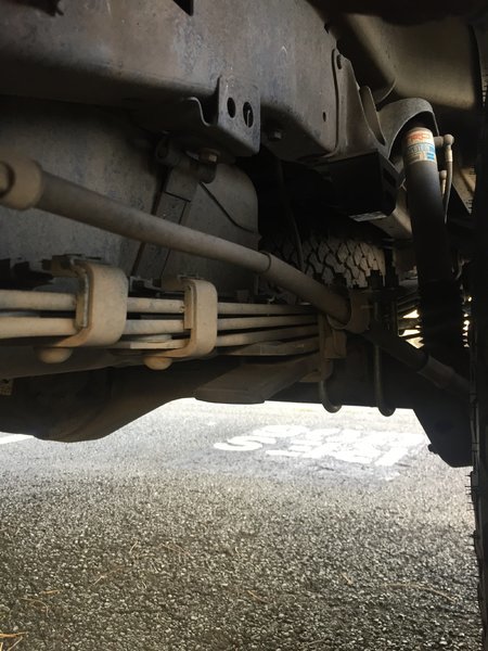

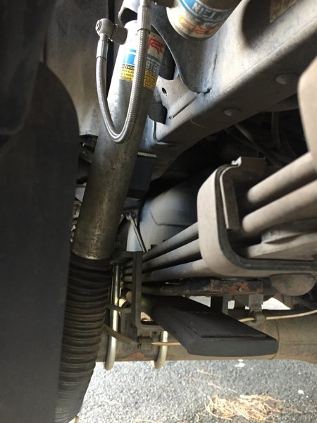

    Here ya go. Or did you mean how it sits now (rake vs squat vs pretty leveled)?

    both, but mainly to see your rake/level

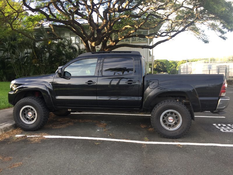

    looks good. what size tires?

    285's

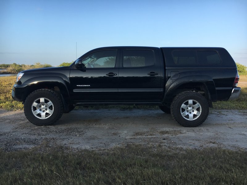

    Got my Dakars yesterday. Installed them today.
    Front's measure about 22" center of hub to the bottom of the fender.
    Rears were 21.5" before. 24" after spring swap.
    If I have extra time tomorrow, I'll install the toytec 1" spacer up front.

    Great looking truck! Curious how it rides with the front spacers? Also is that the OSO in the background? :D

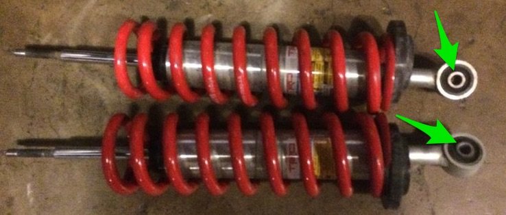

    Reposting here… I tried searching, but can't find any parts for the 9100 outside of some internal rebuilding parts like seals.
  14. Oct 12, 2020 at 10:46 AM
    #594
    JasonLee
    JasonLee Hello? I'm a truck.
    May 9, 2014
    #129454
    12,361
    Jason
    Q322+3C Denver, Colorado
    15 TRD OffRoad
    TRD Supercharger and more.
    Does anyone know where to get replacement lower eye bushings for the front Bilstein 9100 shocks? I called Bilstein and they said "Nah, bro. That's an OEM part, contact Toyota. Also, it's probably bonded in and non-removable".
    Whether or not it is bonded, if I can get replacement ones, I will pop out the old and replace them if possible.

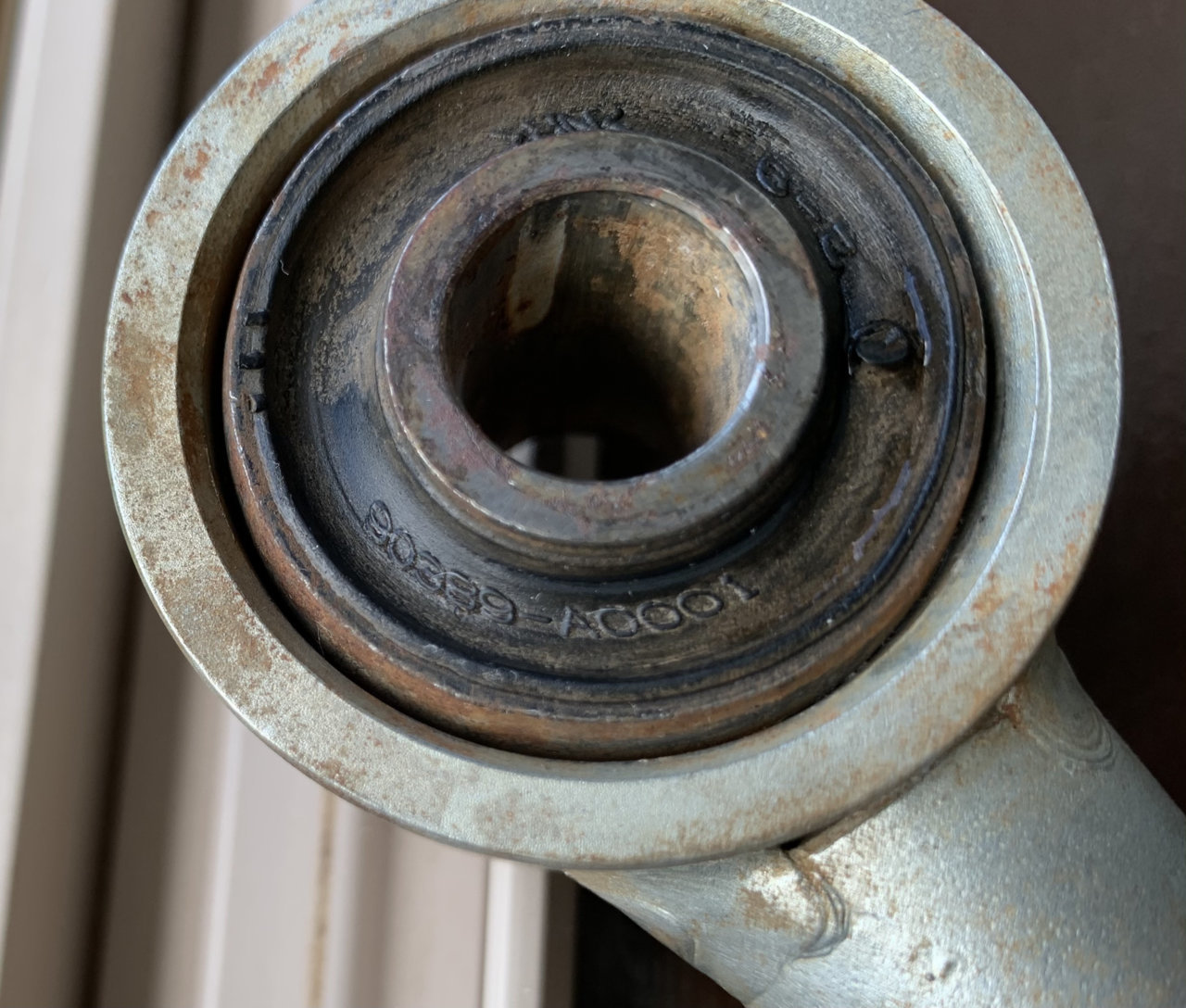

    I have a spare set of these struts, I’ll see if I can locate a part number beneath the layer of red dirt lol
    JasonLee[QUOTED] likes this.
  17. Jun 21, 2021 at 2:22 PM
    #597
    Island Cruiser
    Island Cruiser TVita
    May 20, 2012
    #79166
    3,937
    Kauai
    Baja
    @JasonLee
    90389-A0001
    I haven’t looked it up to verify lol
