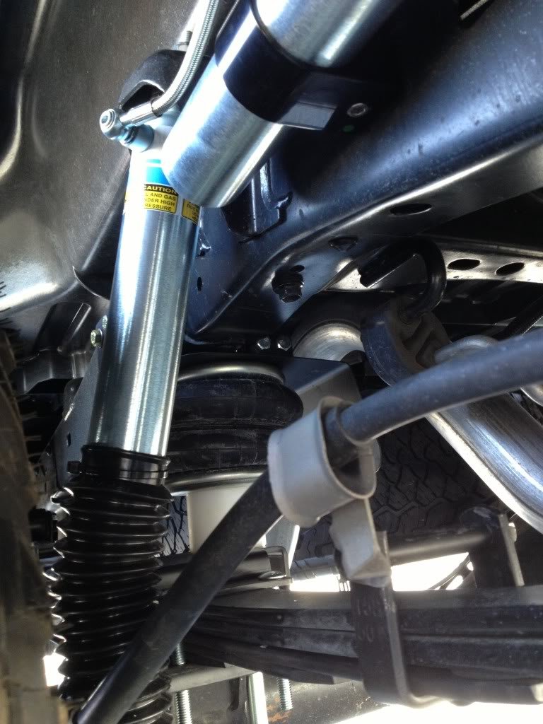

    532
    Getting there!
    836AF682-FBFC-44B0-A9A4-5A1A0F4EDB8D-106_247eef0865673329bb3806226505eb399eeb4d65.jpg
    90839319-CBBD-41CC-A912-166A51E8EFD4-106_f2d724786c7cd03cb45a72b50663b0ecf497901f.jpg

  15. May 25, 2013 at 4:12 PM
    #155
    tacoma steve
    tacoma steve Well-Known Member
    Apr 8, 2012
    #76500
    155
    Steve
    NH
    2012 TX Baja
    Looks like you have the rear res. shock reversed. Here's how my Baja is.the braided line isnt stretched.ImageUploadedByTapatalk1369523450.560019.jpg
    Steve
