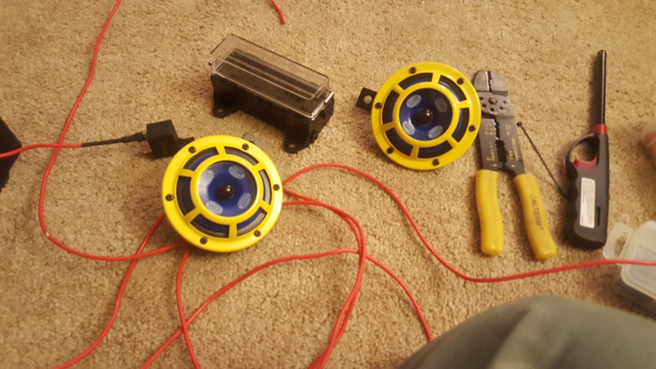

    I was sitting in the living room, building harnesses to do this tomorrow, and I decided to search on TW... Any troubles since not using a relay or anyone thinking about going back and adding a relay? Thanks!20190309_213033.jpg

    From what I’ve read, using the stock wired to power the Hellas does not provide the required power to get the most from the horns. The relay will provide that needed 12v.

    The Sharptones draw less power and you can use the stock power. If you go with the Supertones, then you will need the relay. I went with the Sharptones with no relay and stock power and they are fine.
