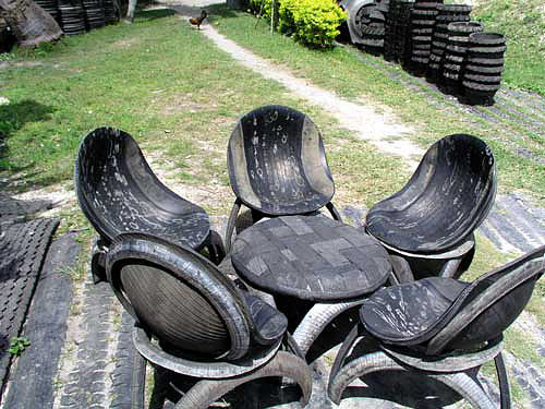

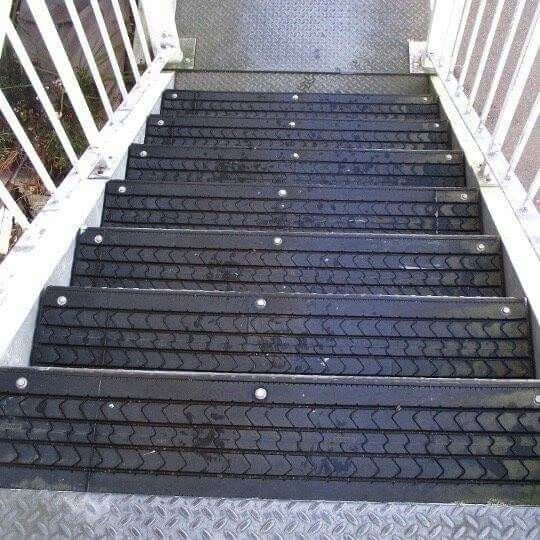

    If you have an available hillside you could use them to terrace it. Fill them full of soil and plant flowers in them.
    Or you can make furniture
    Or retread your stairs so to speak

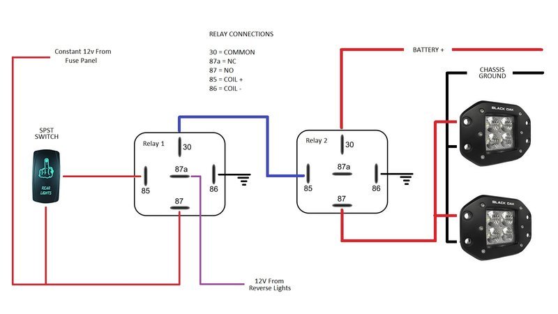

    @Dimestore55 mentioned he was going to use a relay, so he shouldn't need the diode. With a SPDT relay, he can wire the bumper lights to the common pole; tap into 12V from the reverse lights and run that to the NC pole; and run 12V to the NO pole. Then just use a switch to activate the coil. This way with the switch off, the lights will come on when he puts it into reverse, and they'll turn on when he pushes the switch. He might need to up the amp rating of the fuse that the reverse lights use to accommodate the power draw of the bumper lights, but if they're LED, I don't think they'll be that much.

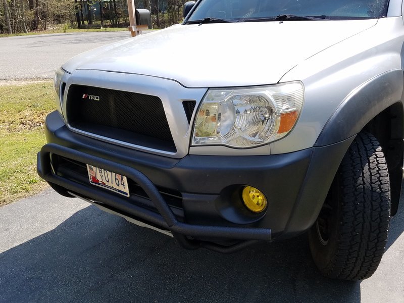

    Thanks to everyone who hooked me up with the Avid light bar. Just got it back from the Rhino Liner, it was a bit of a challenge but she's on.20170414_160318.jpg

    That's a nice looking bar, now you need some lights

    I decided to use 2 relays, now bear with me and I'll explain.
    1. I could replace relay 1 with a SPDT switch but I already purchased switches from Aironboard and they only come in SPST configuration. So essentially I'm using relay 1 to convert the switch to SPDT.
    2. I really don't need a direct battery connection to power those little LED lights but I'm planning to use this same configuration for my Off Road/Highbeams which are 2 x 100 watt bulbs so I'd like to keep the wiring uniform.
    3. I just like to wire stuff :D
    So in the NC position (switch open) the reverse light switch will power the LED's and with switch closed they will be on constantly. Same principle with my high beams when I get those installed.

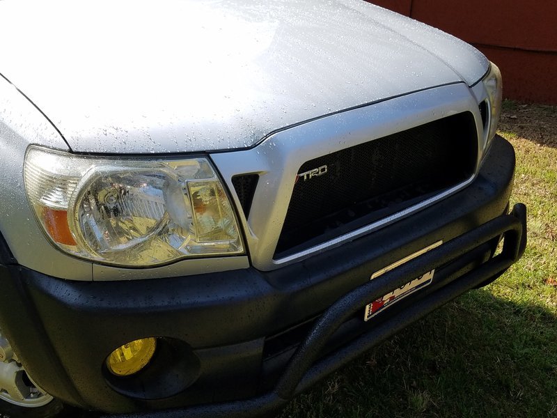

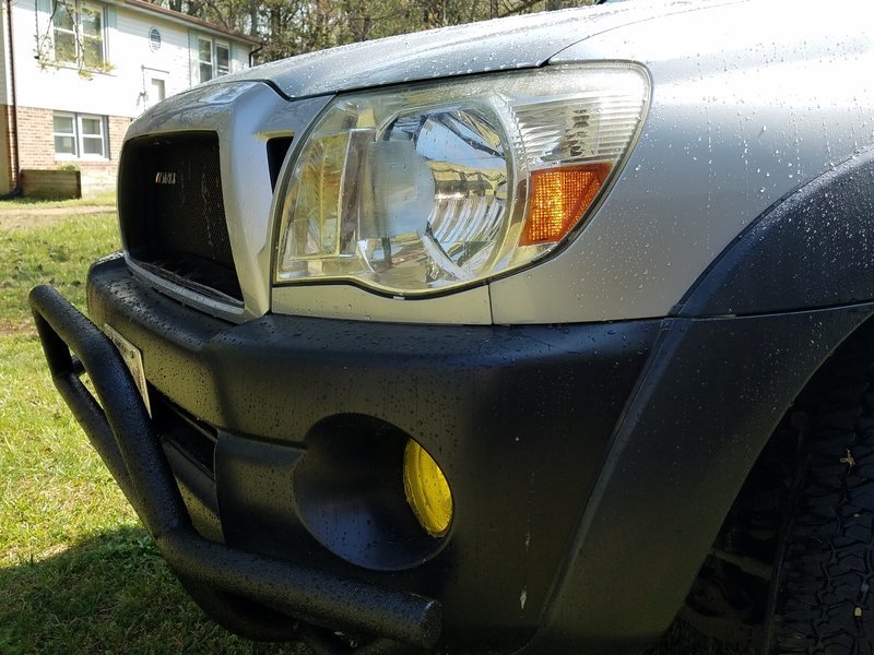

    More pics of my Avid bar...sand blasted, primed and Rhino Lined.

    Yup. That works too. Personally, I would either go with a SPST relay for the second relay or put the battery on the NO terminal and the lights on the Pole. That way there isn't 12V floating out there on the NC terminal as a possible source to short things out.
