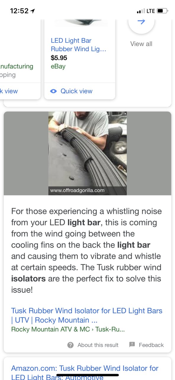

    I had a 50in bar on my jk with no rack did the exact same thing loud howl and vibration did you put the isolaters on the light bar? I had 4 on mine had to call rough country and added 4 more it definitely made it more quiet with more isolaters just a thought

    Do you have a link of these isolators? I threw some basic plastic door gasket strips on mine but it seems to not have much effect.

    That is definitely your problem I’ll look for the link what happens is the wind gets stuck in the metal fins behind light bar

    If it makes u feel better as soon as I installed mine I chucked the isolaters in the trash went 3 miles down the road and was dumpster diving shortly after hahaha

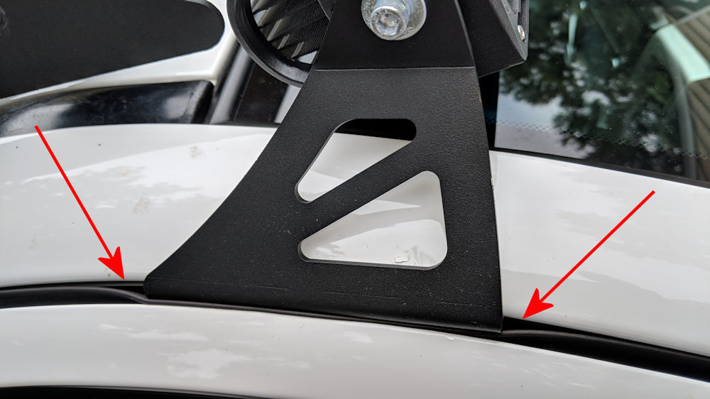

    Here's where the leaks are coming from. You can see (red arrows) how the door gasket has to curve/bend to go around the bracket. It is not sealing tight against the A-pillar.

    Ah Im with you now...May not be a bad idea to put a thin film of silicone around the bracket and then put the gasket back after it dries? Could you snap a pic of what it looks like underneath the gasket? I did similar to my first gen with my light bar rails and I had to silicone my stuff and used a rectangular rubber piece between the mount and the body of the truck. It can be done for sure, just got to identify what the real culprit is.
