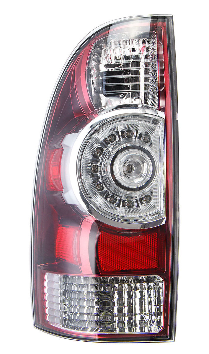

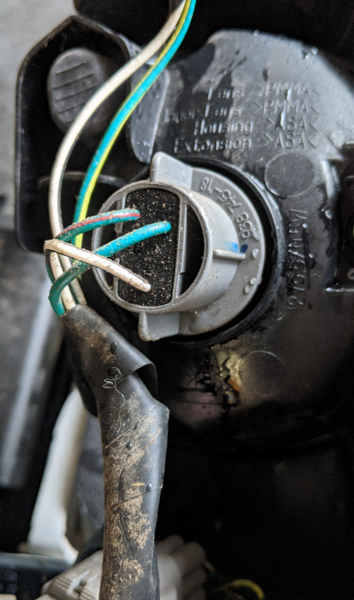

    I need some help here, folks. I had to replace the Third Brake Light unit in my camper shell. Now I need to connect it to the tail light unit so it lights up when I step on the brake pedal.
    I have these kind of lights. When the head lights or DTR light are on, the LEDs light up in a circle. When I step on the brakes, the LED circle lights up even brighter.
    So can someone tell me which of the three wires going into the rail/brake light socket is the one that makes the LEDs get brighter? (This is on the Driver's side). That's the one I need to connect to for the Third Brake Light.
    Thanks.

    White/Black is ground. Green/Red is brake. Green/Yellow is "running" lights.
    Green/Red is what you'll need to use if only looking for brake light function. Will likely needed to be grounded too unless the third brake light is self-grounding.
    I don't remember from when I installed my shell, but does the third brake light need to "run" like the other tail lights?

    The 3rd brake just needs to tie into/tap the oe brake wire.
    I don't think there is any code in VA requiring 3rd brake having a running light requirement.

    Thanks, everyone. Actually, I ended up tapping into the Blue wire on the harness that runs down to the 7-pin Trailer Plug. That did the trick.
