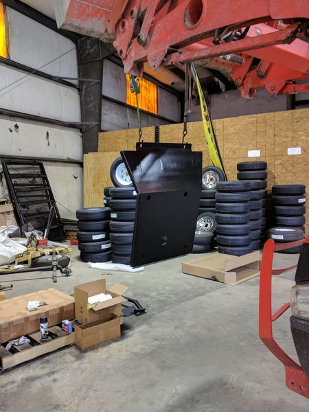

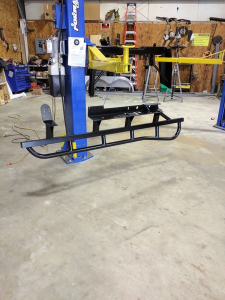

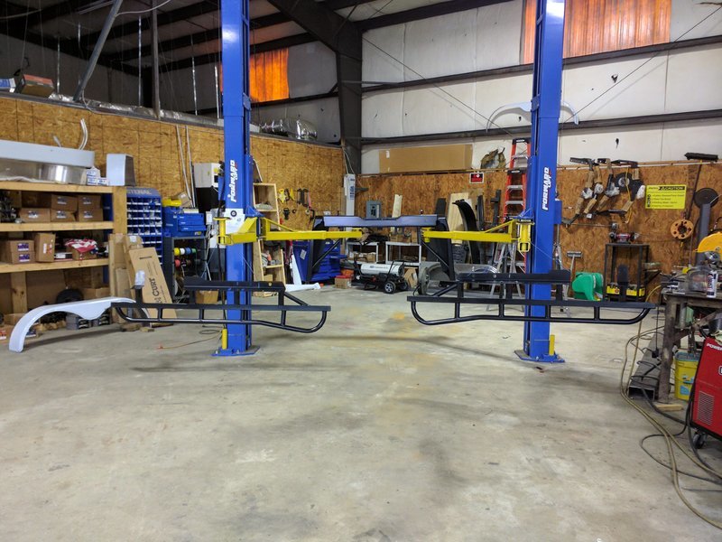

    The bumper I wiped with lacquer thinner, then hit the outside with a wire cup brush to get the metal as smooth as I could get it. Then wiped down with more lacquer thinner, then Rust-Oleum Self Etching Primer. Went pretty heavy and let it sit over night.
    Today, I sanded, wiped it off with a little wax & grease remover, tack ragged it, then Rust-Oleum Satin Black. Closest thing I can find to matching the powder coat on the ARB front bumper I have.
    The sliders and skids I care a little less about, as they're going to need touching up sooner or later no matter what. So I wiped them with lacquer thinner until clean, let that flash off, then hit them with a couple coats of self etching primer, then after about 30-45 minutes top coated with satin black.
    So far it all looks fine. Who knows what 6 months down the road will bring though. Worst case, touch up will consist of some taping off of the truck and a $5 can of paint.
