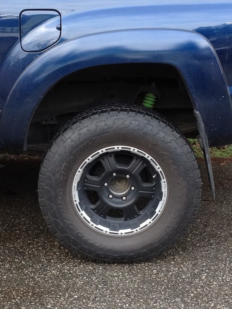

    How did the plates work out? I moved the bed but I was only able to adjust it maybe 1/4" so didnt really help. Its still touching the rear when its stuffed.
    I wonder if anyone has drilled another hole on their lift blocks instead of adding the relocation plates.
    These are my old 33s. With 34 mudders, it got even worse.
