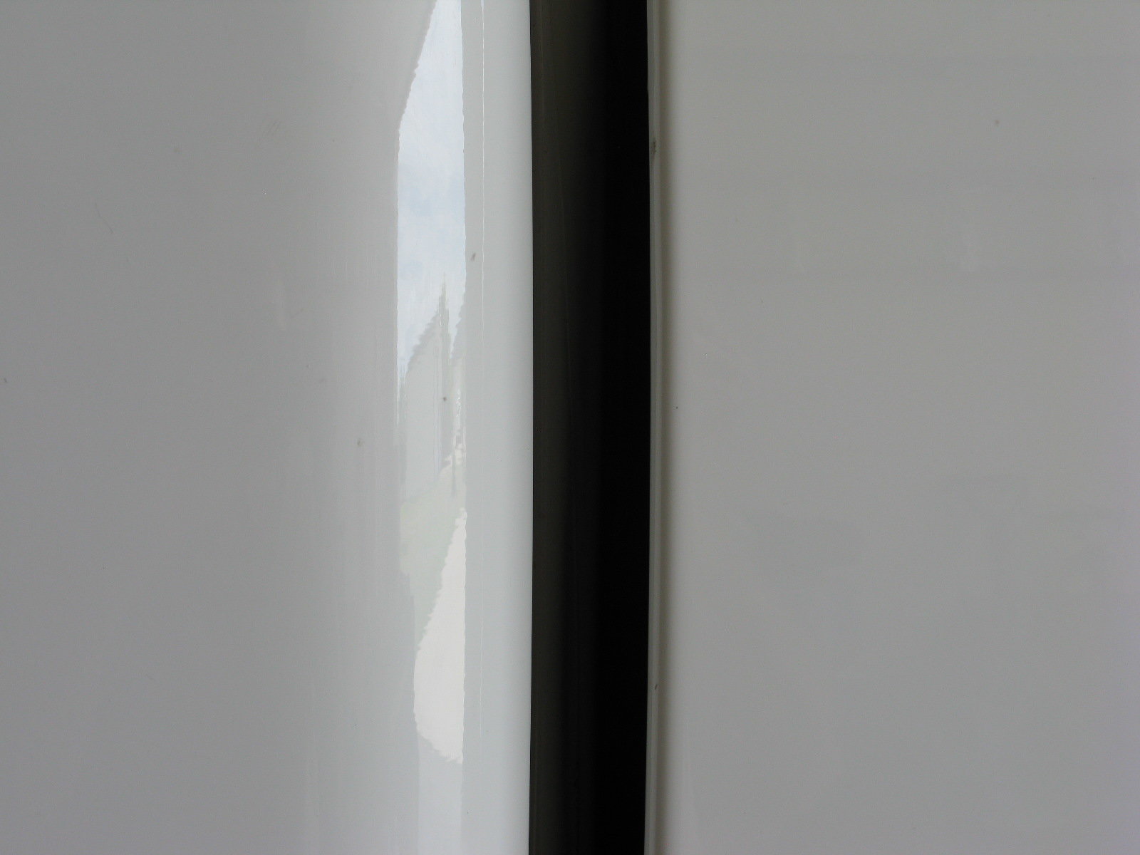

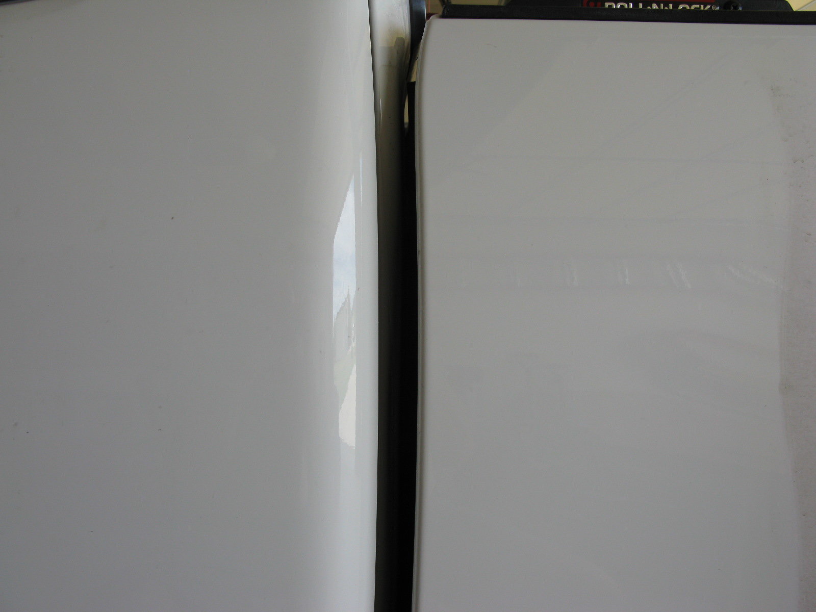

    I'm sure there are threads that deal with this issue but I don't have the time to do the searching. I have a stock 2019 TRD OFF ROAD Access Cab with the OEM Goodyear tires (that will be replaced soon). I only do highway driving. I've noticed that the bed is no longer aligned with the cab evenly. Pictures show that the gap on the driver's side is a little over 1". Passenger side gap is 11/16". Is this something that is easily corrected by loosening the bed bolts and nudging things? Any help/advice would be appreciated.

    Bed could be misaligned, or the cab (or both). The cab bushings are known to fail on these trucks. Can't know exactly what to look at with just these 2 pics though.

    This is really just a visual issue. Not a structural issue. You can only look at one side of the truck at a time. I wouldn't worry about it.

    It’s probably just the bed I would start with loosening the T55 torx bolts and shift it in place.

    If he does some rough surface driving the bed could flex into the cab on the close side. The best bet would be to just loosen the torx bolts and realign it. It’s a pretty easy fix.

    Get a Torx bit and a breaker bar and in 10 minutes you can adjust it yourself.

    Thanks to everyone for the response. I was hoping it would be a simple fix.
