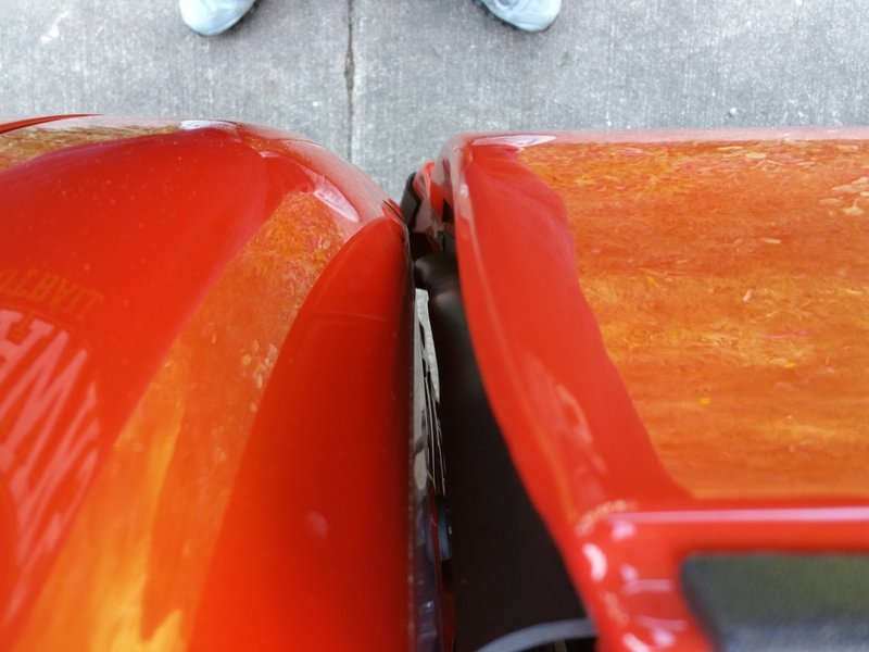

    My bed was out of alignment exactly as vmantrdorlb pictures. I took it too the dealership and at least wanted it to get documented that the bed was shifted, so later on they couldn't blame me for it. But when I picked it up the next day they were able to fix it. Then said they just loosen the bed bolts and shifted it to the correct position. Also, when I dropped of the my truck, I saw that three other new Tacoma on the lot had the same issue.

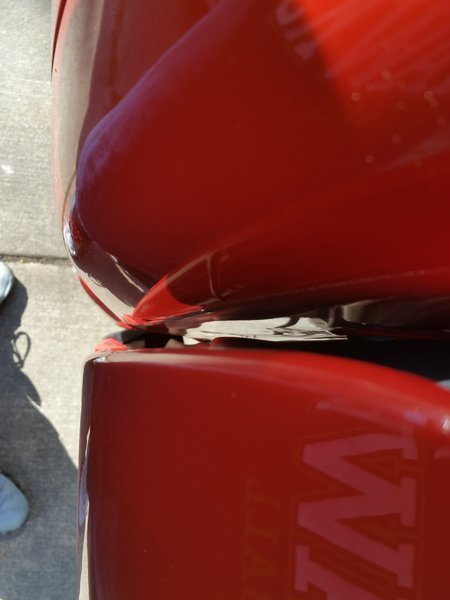

    Mine is off just like yours

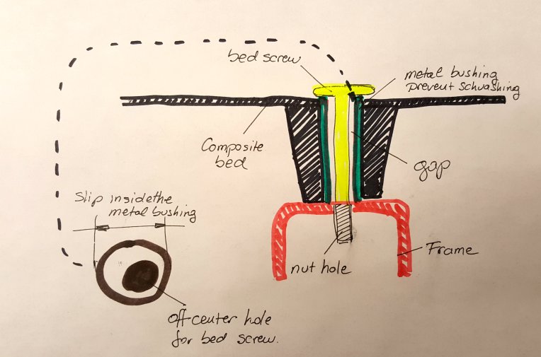

    I had the same identical problem with my 2017 OR taco, the bed was shifted to the left flush with the cabin whereas the right side was exposing the cab a lot. Dealer wanted to take apart the whole box and inspect it, I told him I'll call back. At home I took off the 6 bolts holding the bed to the frame and found the problem, fix it myself for good.
    - frame has 6 screw nut holes for the screws and all are in the center, no problem there.
    - bed is composite (soft material) and has a leg to support it on the frame (is not flat on the frame)
    - to prevent the screw schussing the bed leg to the frame, inside is a metal bushing as tall as the leg of the bed BUT a hair longer past the bed top and the screw rests on it as opposed on the composite bed.
    - bushing inside is about 1" ID compared to the bed screw that is 3/8" (?)
    - since the bed is NOT pressed to the frame and is space between the bed screw and bushing, during movement the bed is walking away thus the uneven alignment to the cab.
    - NEED A MACHINIST TO HELP YOU MAKE THE PARTS! (I have a lathe and made my own parts)
    - get a solid AL rod (hard plastic may work) that fits inside the metal bushing kind of tight but finger moving.
    - drill off center holes for the bed screw to fit through.
    - align the bed to the frame and cabin (use rope to measure if needed) till is perfect centered - DO NOT TOUCH IT AGAIN
    - find the best fitting bushing filler you made to fit inside the bushing and also to allow the screw to pass to the frame without changing bed location to the frame (twist it around till the hole is lined up)
    - repeat for all remaining screws.
    - tighten the bolts to the bed to frame
    Problem solved. Your bed will not shift anymore since there is no more gap between the metal bushing and bolt allowing the bed to shift position.
    Buy me a beer for solving your problem

    @Dacon Any pictures of the parts you fabricated? Really interested

    Parts with the truck gone...

    :annoyed: Alright, glad that drawing is there though. Would of been perfect to have a real/visual reference.
    BTW, was solving this issue hard? What was the process like? Bolts torqued to what setting?
    Sorry for all the questions. This mod is extremely helpful down the road. Thanks!

    If you come to Phoenix, I will do it for you.
    Questions now to help you.
    - is your bed misaligned?
    - how? where. (pictures)
    - take one bolt out of the truck bed.
    - take a good and clear picture inside the hole as it is now and post it here and will explain.

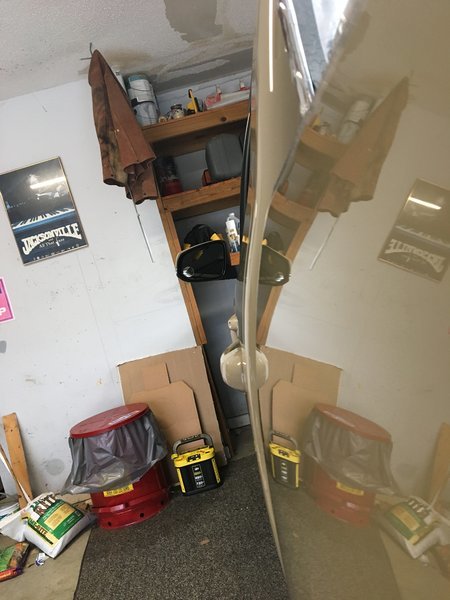

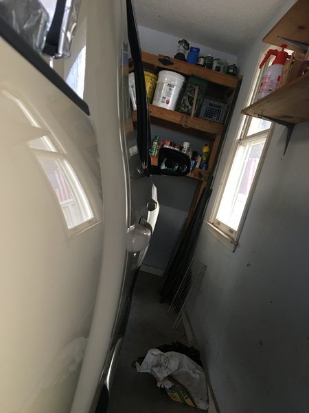

    Passenger20160402_155048.jpg driver side
    20160402_155022.jpgI don't really care ,I just drive it as is.
