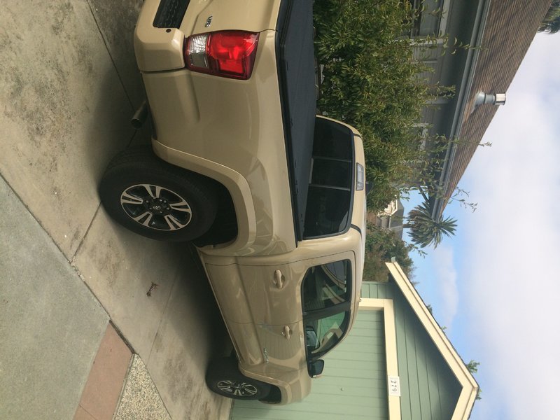

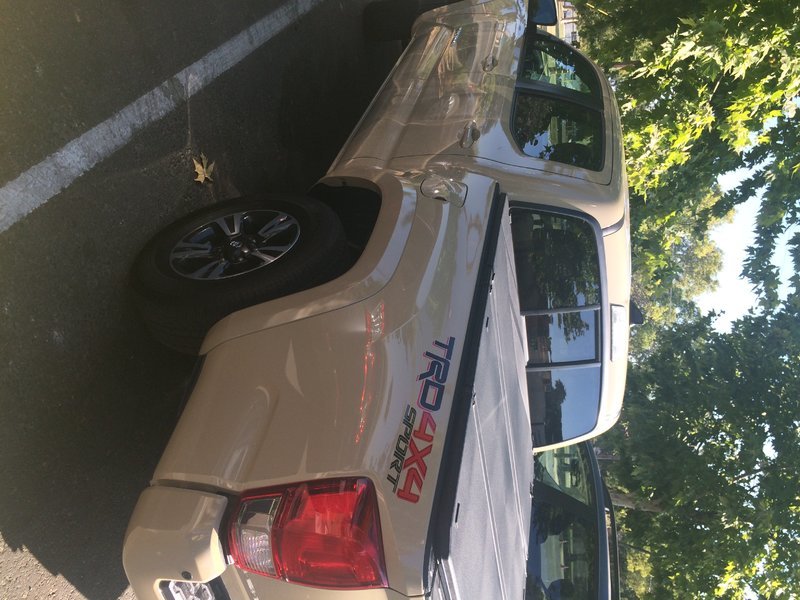

    Fortunately, I took photos of the truck the day of and the day after I bought the truck.
    Let me know what you think? Was the bumper out of alignment when I bought the truck
    The day after photo has no TRD badging on the bed

    Looks like a larger gap on the left side but it could be the angle of the photo.
  7. Mar 9, 2017 at 10:23 AM
    #87
    ICU1
    ICU1 Well-Known Member
    Sep 3, 2016
    #196340
    4,531
    That's correct. The gap on the left side is almost an inch bigger than on the right side
