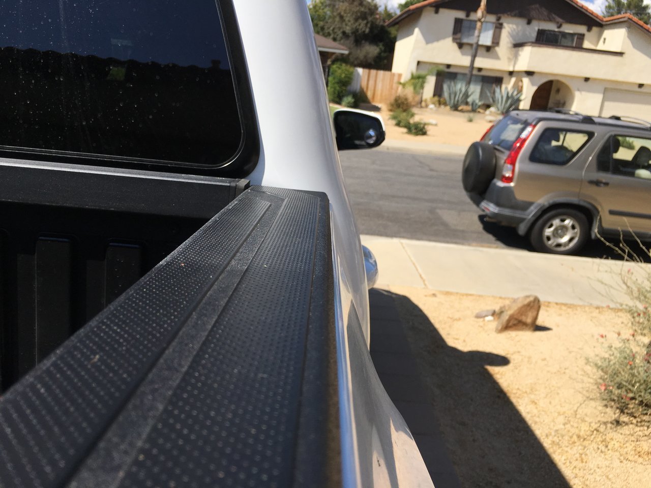

    Noticed mine was off when I put a topper on it. I thought the topper was off at first but upon inspection my cab was actually off too. Had to loosen up the cab and shake it into place.

    How (from what bolts - how may - where located) did you loosen the cab to align it? Did the cab moved easy or with a lot of muscle? How did you align it? Based on what measurements?

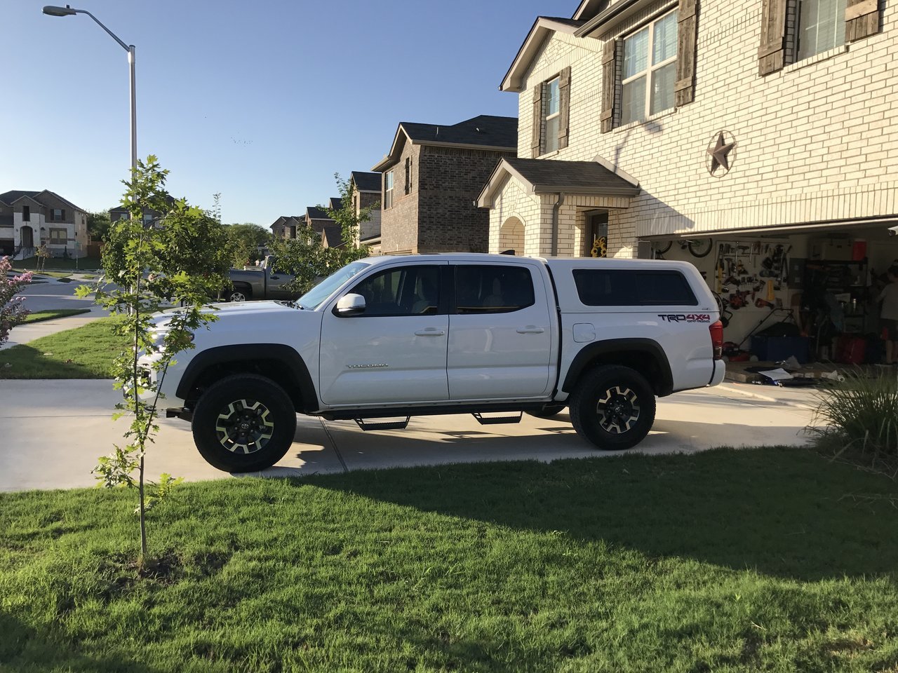

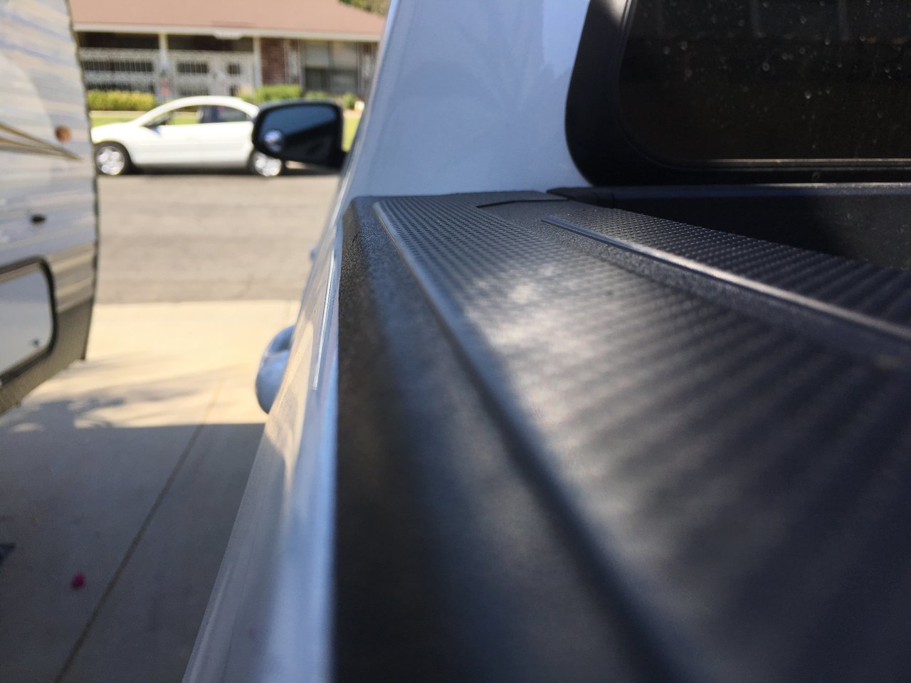

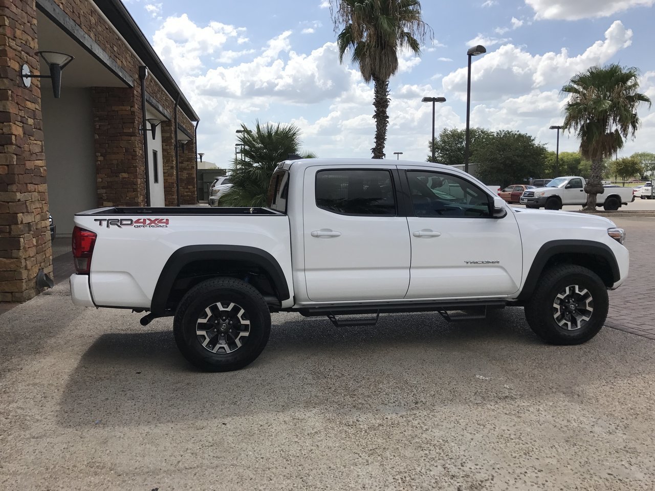

    IMG_2387.jpg IMG_2392.jpg My bed gaps are off pretty bad. Bumpers also but not as significant as some others in this thread. I also notice when driving down bumpy roads, the cap and bed shake quite a bit. How did y'all adjust and tighten it? Or should I be taking it to the dealer for this?

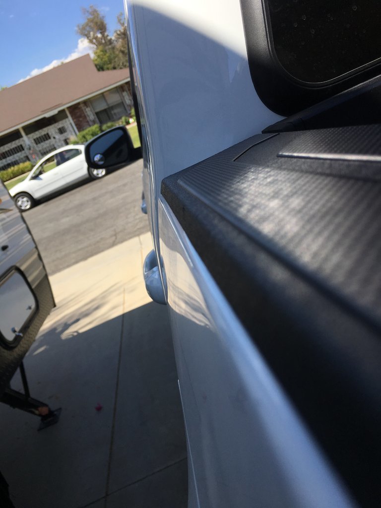

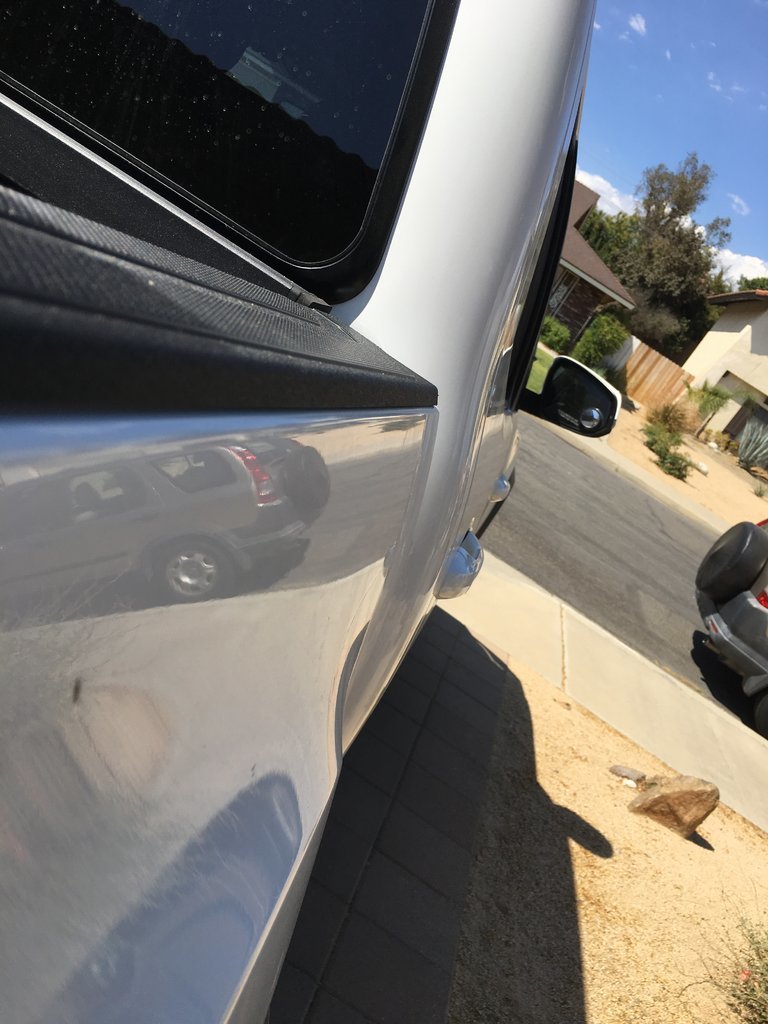

    My new 2017 has the same problem with bed to cab alignment- I didn't notice it until I put a shell on it. When installed squarely on the bed, the drivers side of my ARE shell stuck out to the side, while the passenger side didn't. I broght it to the dealer and the repair manager said they'd fix it and give me a loaner. He said it requires a cab realignment too as theyre both adjustable. I've since removed the shell to bring it back to the dealer tomorrow (they are sending it to their body shop), but these pics should show the problem:

    Update- Dealer sent it to a Toyota collision center and they fixed it- the cab and bed was out of alignment. Toyota covered it plus a free loaner.

    It is an easy fix, either by you or the dealer. Loosen bed bolts, slide to align.It can be done with camper shell on.
