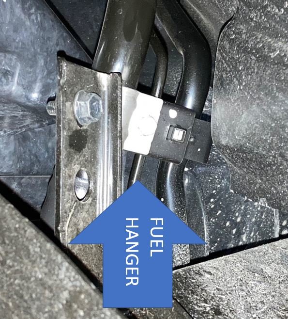

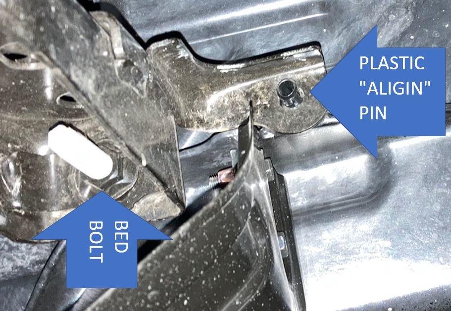

    Bumping an old thread. My 3 day old DCLB OR has the bed alignment issue. I thought it was as simple as 6 bolts, but I looked underneath, and there is a plastic "alignment" pin on drivers side near front bolt that looks like it will need to shear off to move bed.
    There is also hanger for fuel neck and vent tube that attach to frame that looks like they should be loosened to allow new bed position since fuel tank will not move.
    Anyone take these two things into account before shifting bed?
    Lastly I pulled two front bed bolts just to see how much adjustment they could have, and it appears I can make the 1/4" movement I need to get 1/2" total change (+1/4 to drivers, -1/4" from passenger).

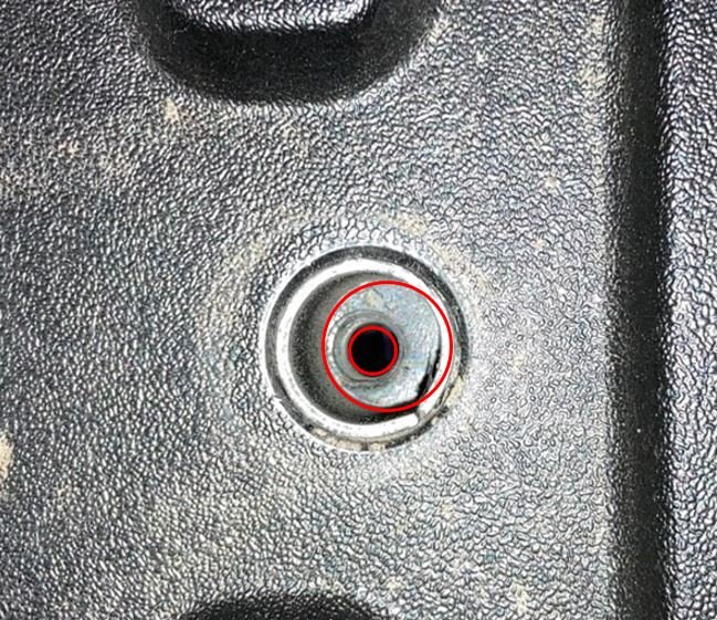

    At least on my long box, there is more to the alignment than just 6 bolts. There were 2 conical plastic pins that were preventing me from getting the alignment I wanted. One near the driver side front bolt, and another near the driver side rear bolt. The rear one you can remove easily, the front one is blind, and I had to push it up into the bed pocket.
    I also loosened up the fuel neck assembly clamp while getting the bed as good as possible, then tightened it after I was happy.
