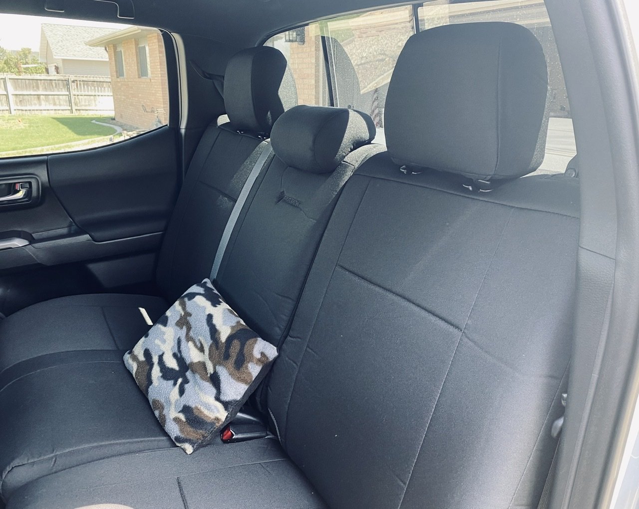

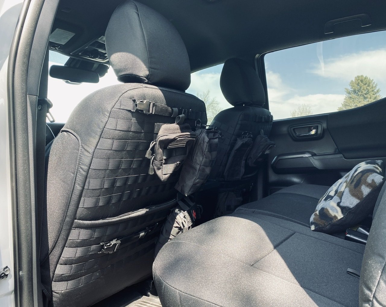

    My Bartact seat covers. Material is a padded polyester blend that takes a ton of abuse. Didn’t feel like steaming out the wrinkles and the last set I had settled in a few days so the fit is misleading at the moment. They are also washing machine safe, but wipe off really easy.

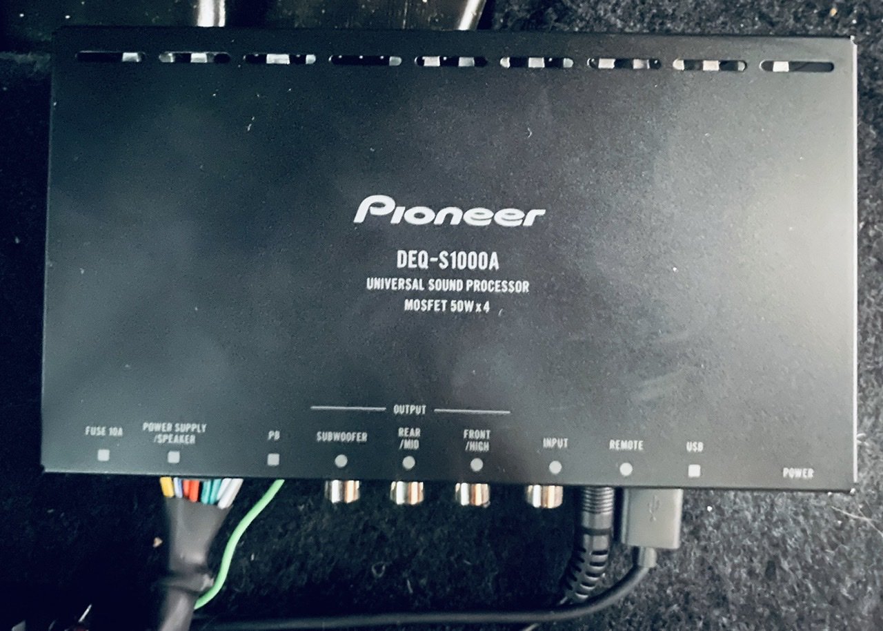

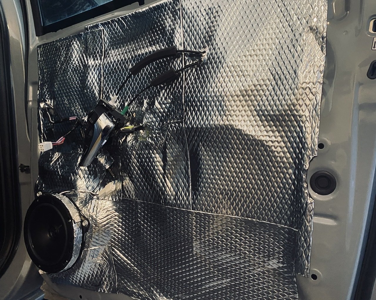

    Installed pioneer DSP (w/built in 22w x4 amp), then rear doors with sound deadening and rear speakers. Fronts were already done.
    Couple weeks will be DSP to 5 channel amp, run new wires to the speakers and add a 10”. I wanted to see how this would sound first though.

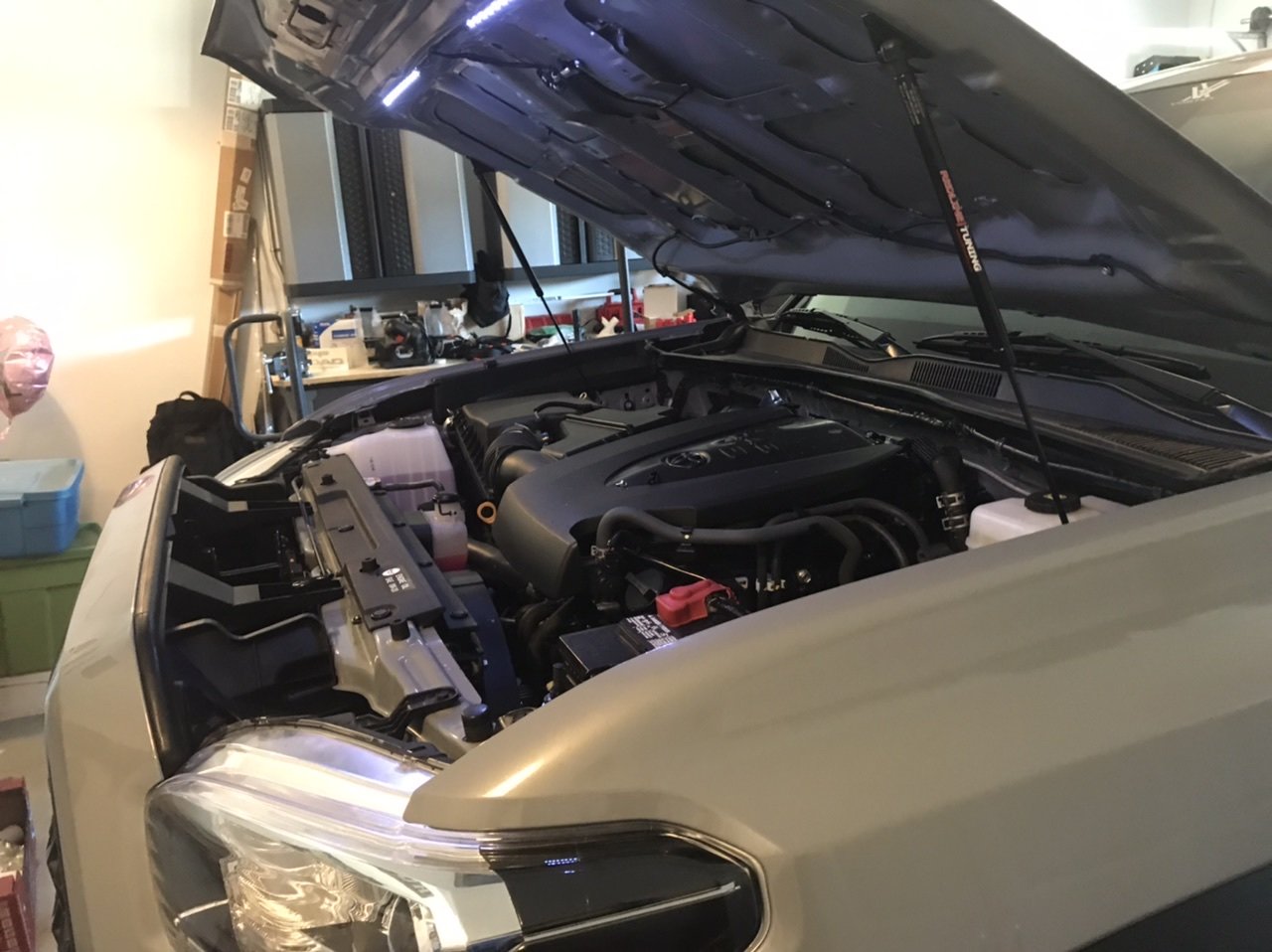

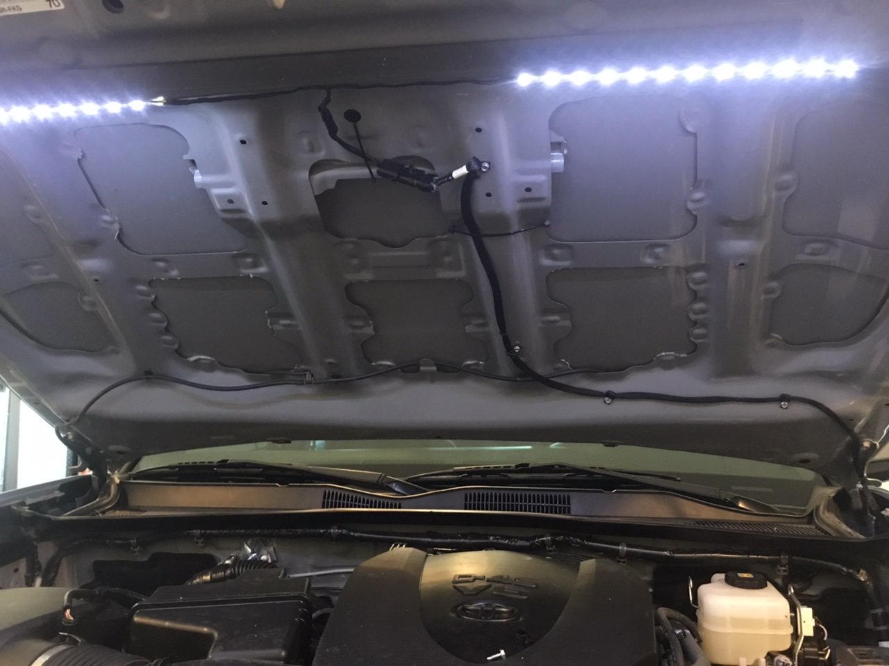

    Interested in the hood lights. Did you use a mercury switch or a different type? Where did you buy the lights themselves?

    It’s a pin switch... wired to the ground.
    https://www.amazon.com/gp/aw/d/B00RT2WLQS?psc=1&ref=ppx_pop_mob_b_asin_title
    https://www.amazon.com/gp/aw/d/B07CPL376T?psc=1&ref=ppx_pop_mob_b_asin_image
    @My Name is Rahl
    Edit:
    Swapped from this switch. The silver one is better quality and better adjustment. Both installed in the same location.
