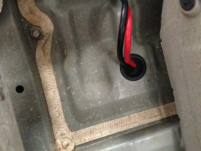

    Probably not the setup you are looking for (this is more for expo/camping), but I put my second battery in the cab (in the cab could still an option for you)
    Used a national Luna power pack with an odyssey 31m. I run the same battery in the stock location.
    The NL power pack has all the dual charge controls built in. And best part is its portable so it's easily removed and used in other vehicles.
    I ran the wires along the frame rail and up through and existing grommet.

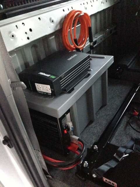

    Icon Shocks, BTF front, Deaver f67, 33's on stocks, Fiberwerxs 1pc, TDR S/C, Bed & Eng Caged
    Self made tray and clamp. Harbor freight disconnect switch.

    That's a good looking set up!
