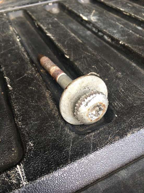

    I used a pair of vise grips and a cheater bar. Pretty much mangled the bolt, but I got it out. I tried PB blaster, Air Impact, cordless impact, breaker bar,.... The thing was frozen. The new bolt was around $10 from the stealership.

    I would be very careful in how much force I use.
    The bolt sits in a “well” molded into the bed (to raise the bed up off the frame). The well is covered by the big fender washer under the bolt head. There is about 2 inches of unsupported bolt shaft between the bottom of the fender washer and the point where the bolt threads meets the nut.
    Water can sit in the well and rust the shaft of the bolt, weakening it. I broke one of mine going caveman with a cheater bar. It was a PITA to drill out. I was lucky and saved the threads of the captive nut in the frame, but that was a long afternoon.
