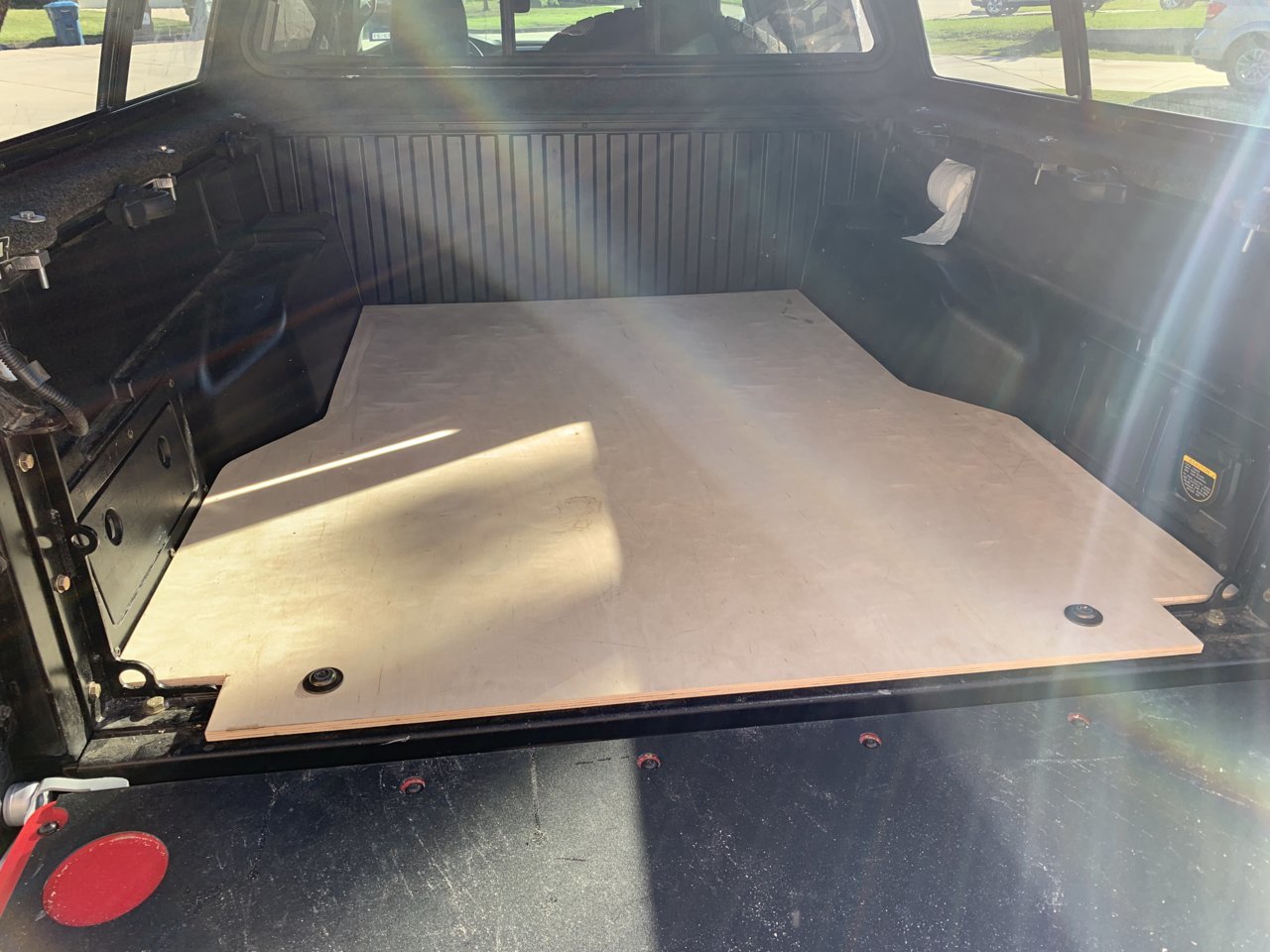

  20. May 1, 2021 at 9:20 PM
    Cometelf
    Cometelf Active Member
    Apr 26, 2021
    #363934
    26
    Joshua
    2006 Toyota Tacoma PreRunner
    New Battery with new cables Blue Sea Terminal Block
    Curious if I can revive this thread. I have an ‘06 Tacoma
    The shoulder is about 4.7” long, but the threaded portion seems to be able 3.75” (measuring a current bed bolt that I took out)
    I am trying to find a longer bolt, as I put 0.5” of wood down and am looking to mount it with the existing holes.
    I may drill out some of the wood to get the depth needed, but from looking at it, it looks like I would have to drill completely through the wood, which defeats the purpose of me mounting the wood to the bed.
    Any ideas or even part numbers to mount the wood to the bed? I don’t want to glue it and I don’t want to add more holes to the bed.
