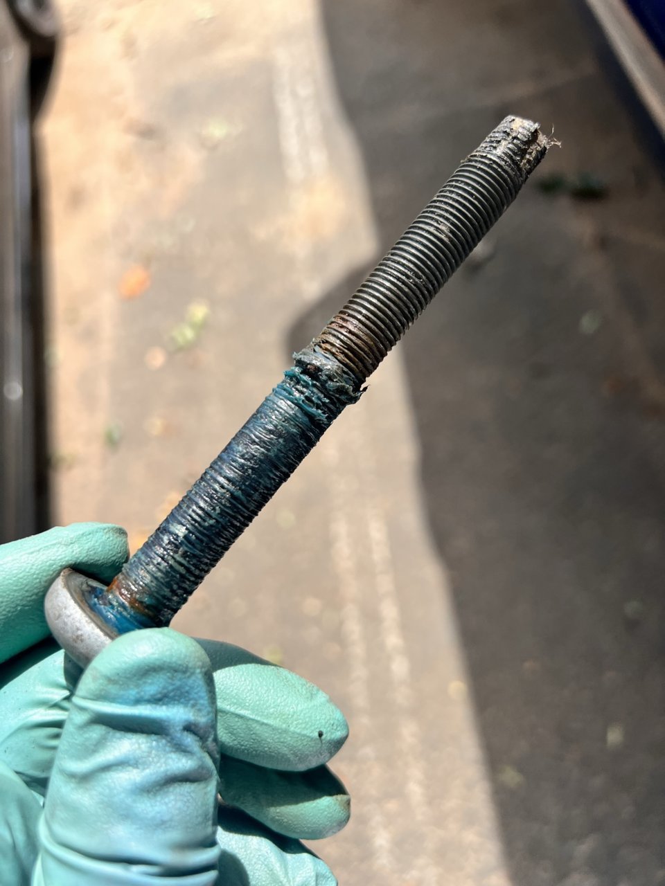

    Just going to update this real quick. I removed mine again today to clean them. I forgot I had applied Marine Grease to the 2 forward most bolts and Aluminum Anti-Seize to the back 4. I was pleasantly surprised to find that the marine grease did an outstanding job! Much better than the anti seize and these 2 were, arguably, in the toughest location when it comes to developing corrosion. The middle two were starting to show signs of rust and the back two were discolored and presumably on their way to corroding.
    Next time I pull them again, they'll all get marine grease. Pic of the two for reference. IMG_0094.jpg

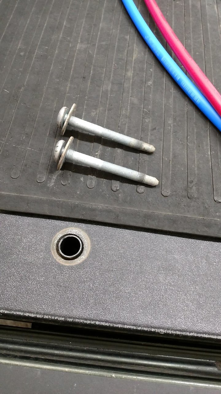

    I know, you're all jealous. These are what I pulled out of mine a few months back. Greased them up and reinstalled.

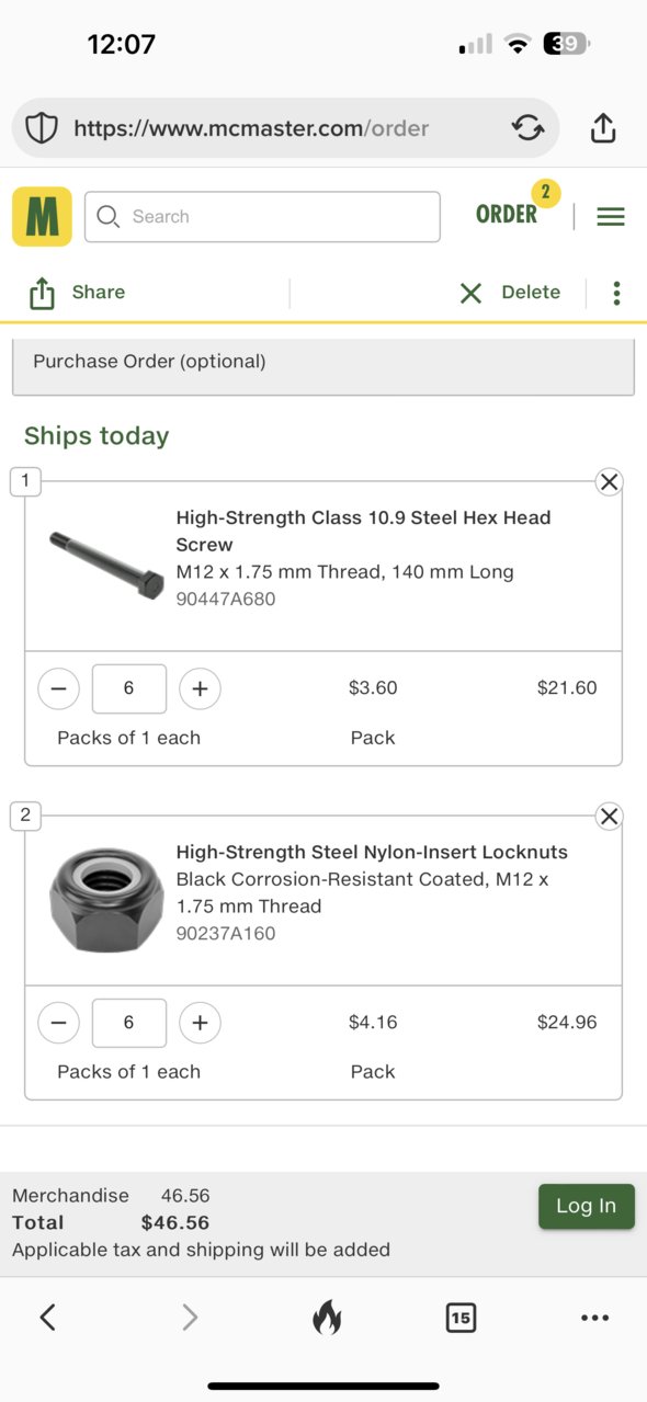

    Anyone know what size bolts these are? I stripped my nuts out I think. Anyone know how to fix? I’m thinking just adding another nut underneath if I can even access it without dropping the fuel tank. Probably have to drop the fuel tank. :(
  12. Feb 16, 2023 at 9:29 AM
    #32
    jetbuilt
    jetbuilt Member
    Feb 9, 2023
    #417524
    5
    2012 DCSB Prerunner
    Bajakits, glass fenders, method race wheels, 35" Toyo's, and a ton of other crap
    M12 x 1.25 120mm long. I ordered these from Home Depot but haven't had time to check fitment yet, I can possibly look at it tomorrow afternoon.

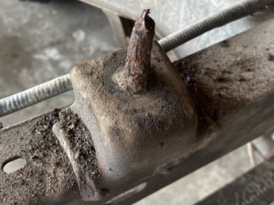

    my bed bolt after cutting the head off to get the bed off to get the bolt out ... '05 -- original owner. the frame is in good shape. 2 of the bolts were a mess. This was the worst.

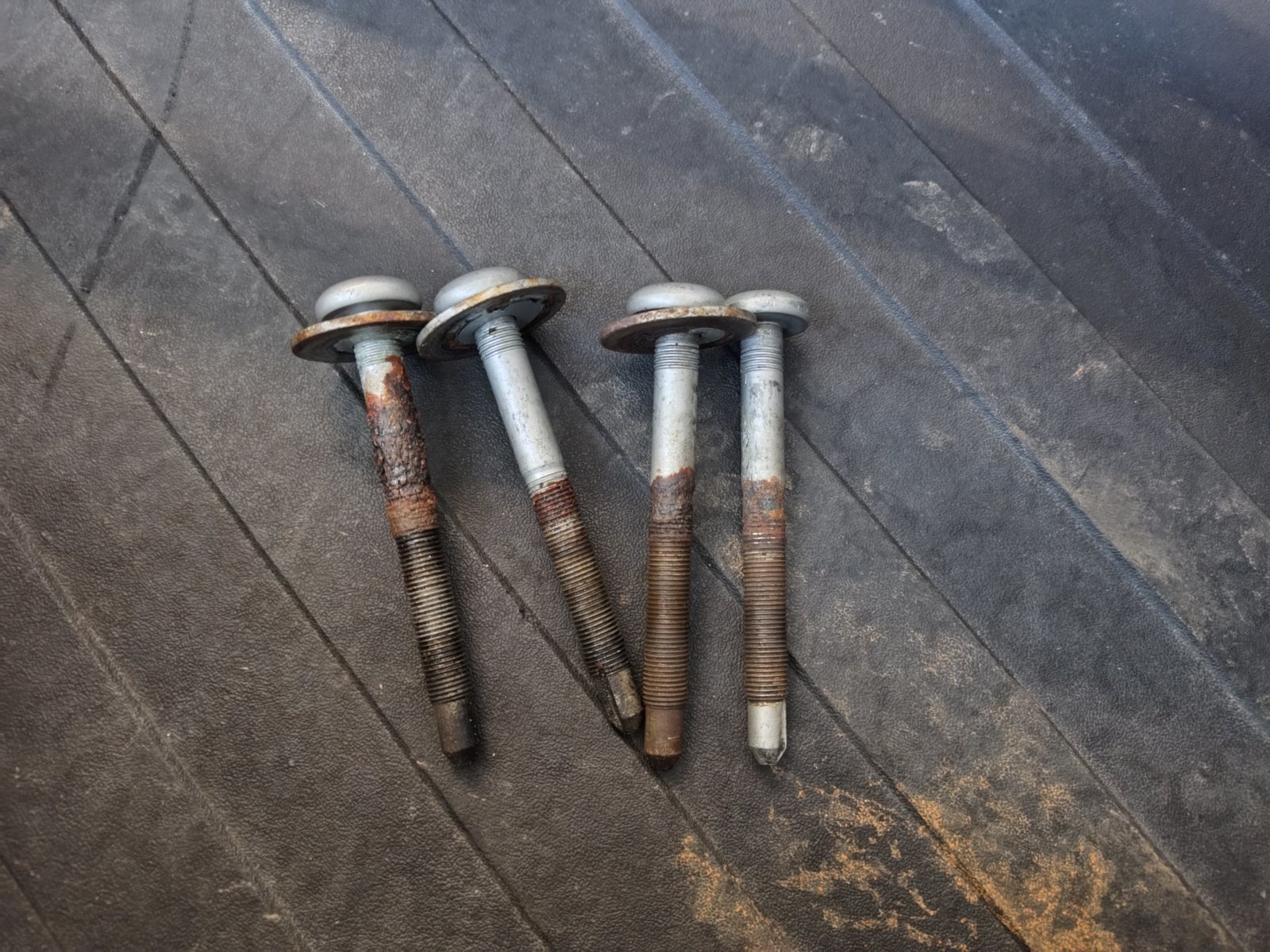

    This is your reminder to check and change your bed bolts. Here's my 15 year old bed bolts IMG_20240701_165231558.jpg only had to change 4 as the rear most looked practically new.
