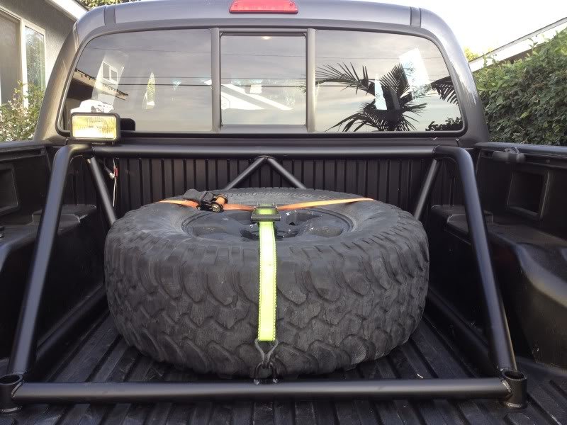

    [​IMG]mine.. more pics in my sig if you need

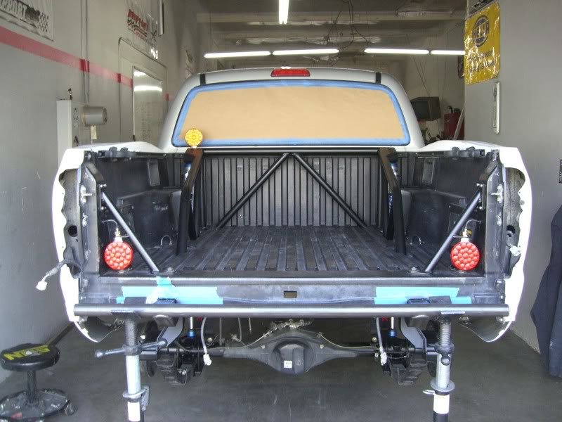

    A few from DMZ Race & Fab

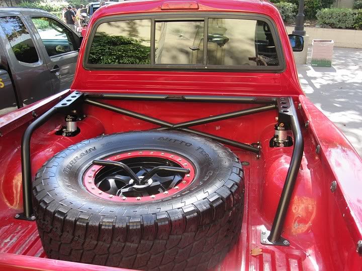

    That one is custom built by DMZ.
    Here is mine full function bed space :D.

    what size shock is that ? And where did you get those shock mounts? They dont look like the go through the bed at all.

    Shocks are 2.5 x 12 triple bypass. The shock mount was custom made by DMZ and it does not cut into the bed at all.

    Do you have more pictures? So your running just hoops? No crossmember or connecting support of any sort?

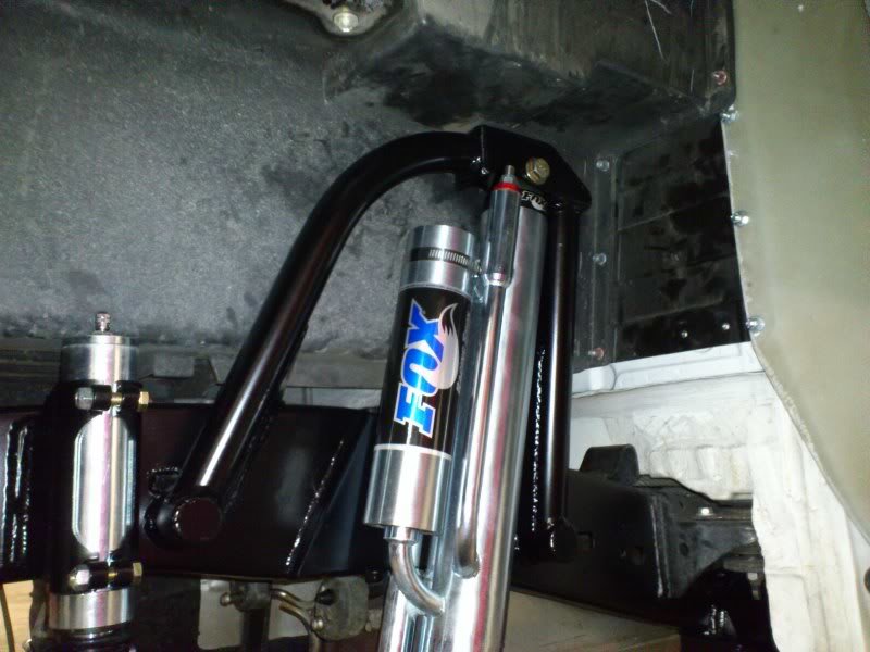

    Here is another pic. The hoop is gusset to the frame if you look close at the attached pic.

    CLEAN!! I'll be doing a similar setup next week, using shock hoops from Defined Engineering. Have you ever fully cycled your pack to measure exact wheel travel? How often are you riding bump with that setup? Any additional pics would be awsome. Do you have a build thread?
