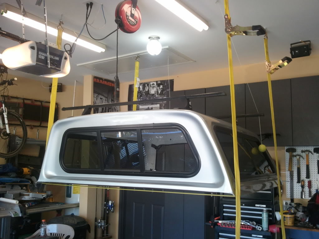

    I just put some eye bolts through the ceiling joists and use some ratchet straps to lift it off the bed. Mine pretty much stays on all the time. I've only taken it off 3-4 times in the 2 years I've had it. If I need to haul something tall, I usually just use my trailer.

    I built a frame in the shape of an "I" out of 2x4s. Hung straps from the frame that loop around the topper. Eyebolt in the frame, pulleys on the garage ceiling, wire cable running through pulleys to a harbor freight hand crank on the wall.
    15-20 minutes by myself, top on or off
