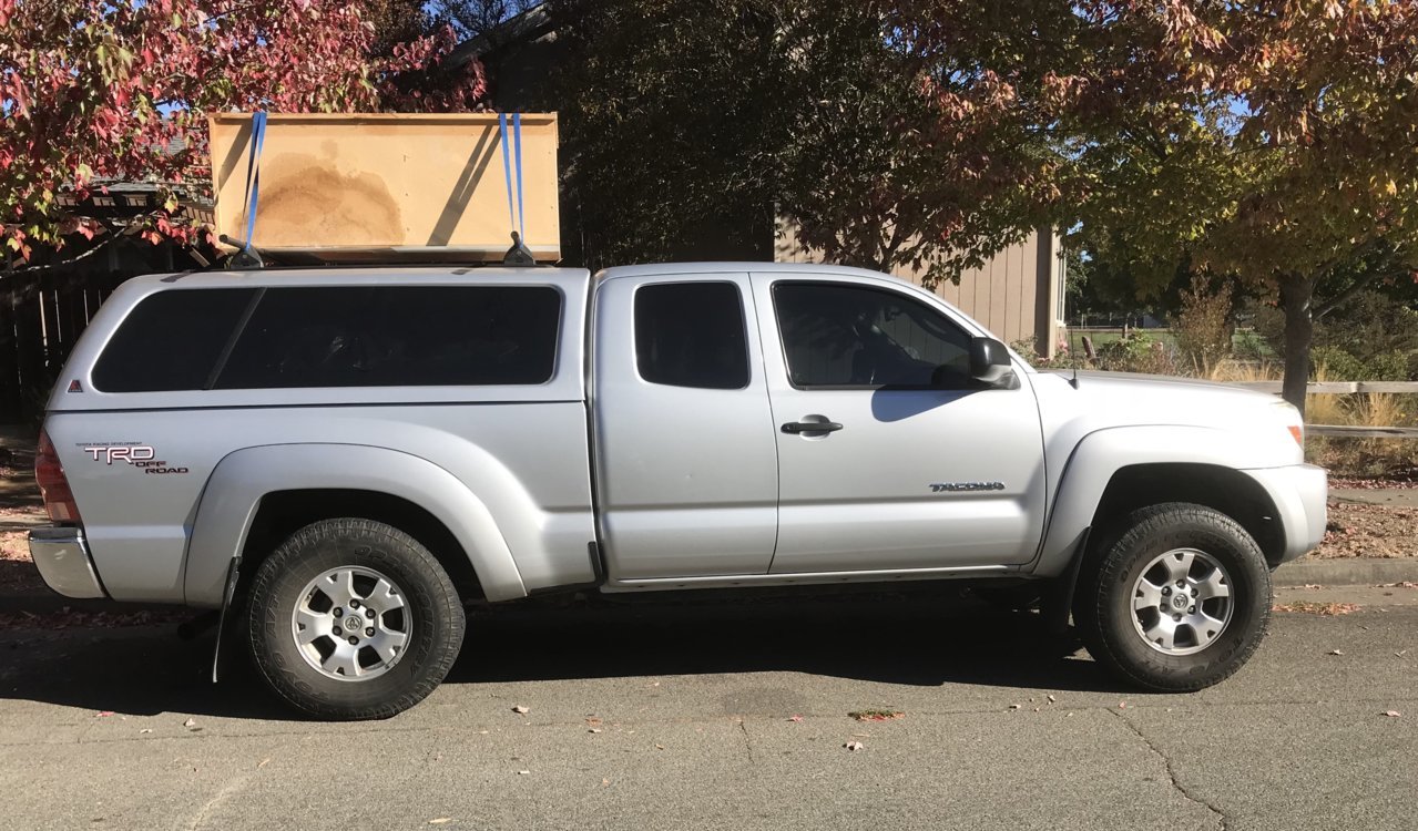

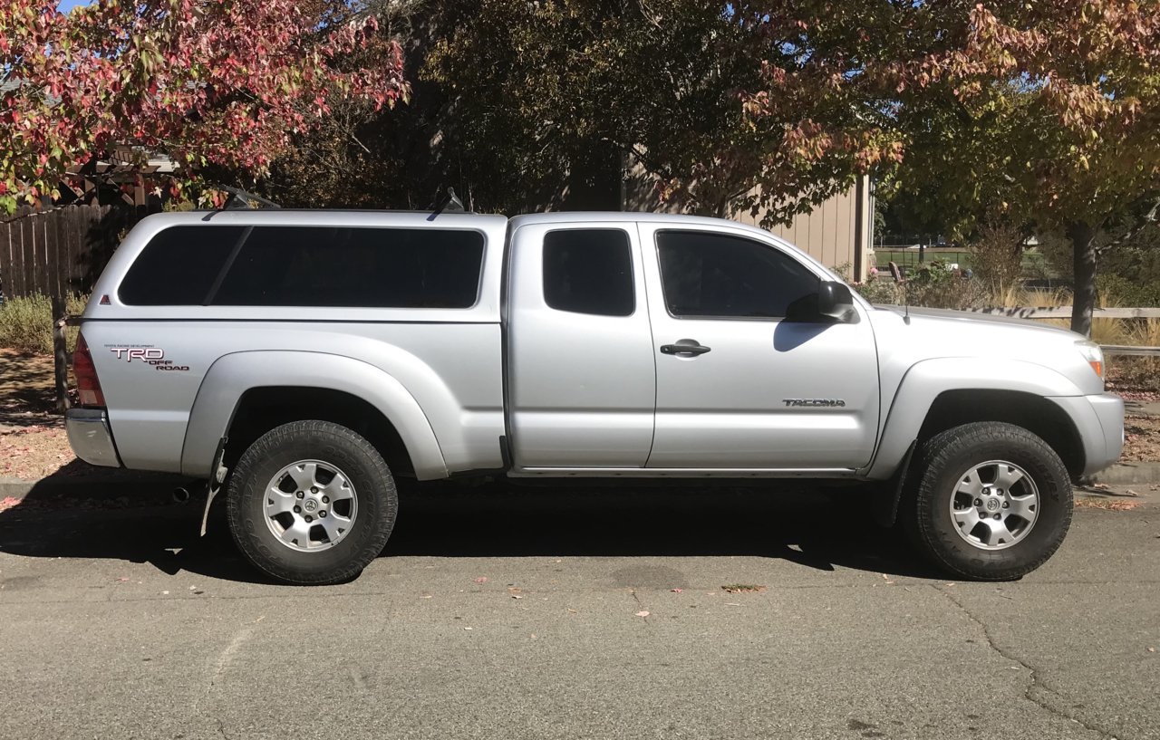

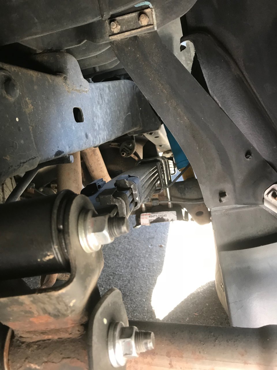

    Here is a before and after of my '06 4x4. It usually carries the topper shell and a coupe hundred pounds of tools , photo 1. Photo 2, loaded across the scales with 1580# from a bathroom demo. Photo 3, is the TSB springs with an added original spring as an add-a leaf under 1580#.

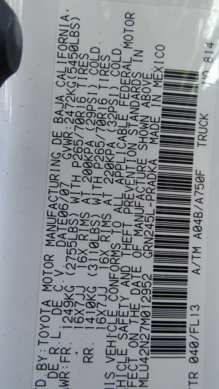

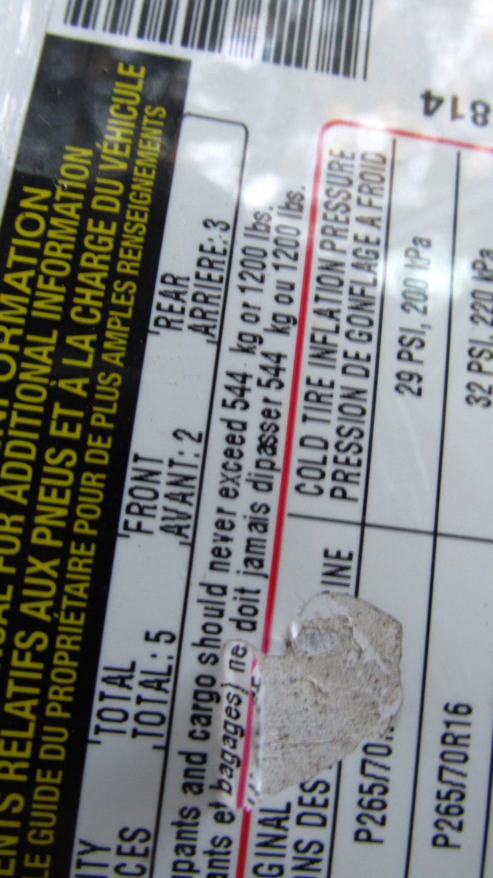

    There is a sticker on the drivers door jamb with "payload" written on it. You may have to read carefully to find it because it has other info on there. My truck is rated for 1200 lbs. There is also a GVWR on another sticker. My truck is rated for 5450 The total weight of my truck, any passengers and cargo should never exceed 5450 lbs. That means that my truck weighed 4250 lbs when it left the factory. 5450-1200= 4250.
    But my truck no longer weighs 4250. With me, my wife, the cap on the truck it weighed 4800 recently at the landfill meaning I had 650 lbs of usable payload. Leave my wife at home and I'm closer to 800 lbs. Take the cap off and I gain another 180 lbs.
    Every truck is somewhat different so the numbers won't be in the owners manual. Most all of them have a GVWR of 5450, but every trucks weight is somewhat different depending on the cab style and options. That is why you have to look at the sticker on each truck. And if you've modified the truck in any way you really need to actually weigh it.
    Do people overload their trucks, you bet they do. And so have I. For short hauls, driven carefully and occasionally I'd not have a problem overloading it by 200-400 lbs. But not more than that, and I wouldn't make a habit of it. If you do, you need a bigger truck.002.jpg 003.jpg
