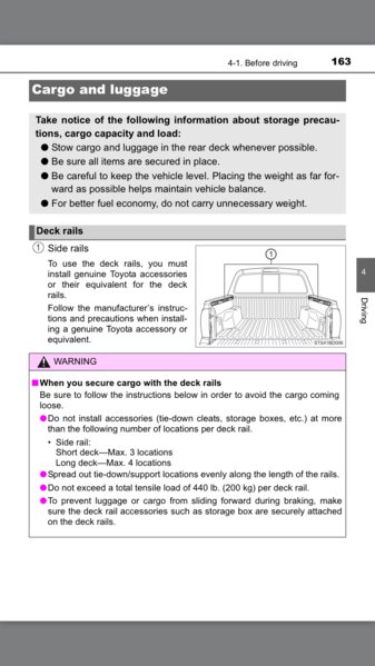

    My question is, will the OEM bed cleats be strong enough to hold a 150 pound generator and 100 pound tool box in place via ratchet straps?
    I read the cleats working load is 100ish pounds each but not sure how that translates to just holding these items in place so they don't move around.

    I have used the oem bed cleats to tie down with rachet straps heavy metal furniture weighing easily 200 pound+ with no problems.

    Straight from the manual.
    Read the Pink bullet points
