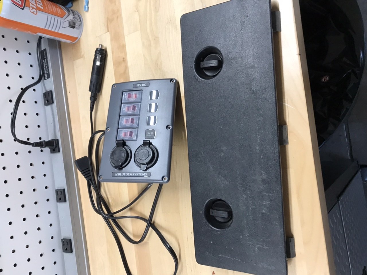

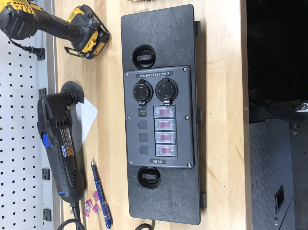

    You can use it to wire in power outlets and switches. I used the opposite cubbie to add a blue sea breaker system for camp lighting and fridge.

    Can you post more details and pictures of this?

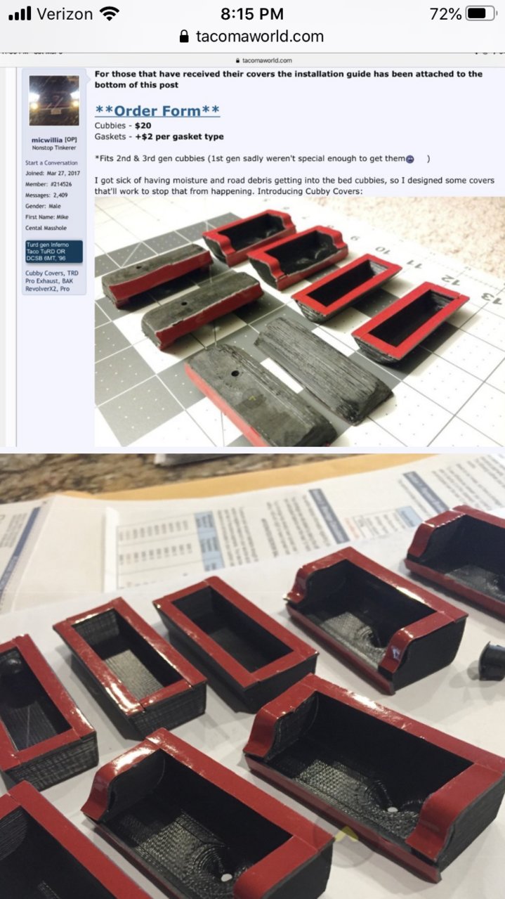

    Bungees etc. buy the kit that a tw member makes to make them waterproof. Much more useable

    This would be as simple as putting some weatherproof stripping along the edge of the cubby door, right?

    Yes. But you can also add some plastic pieces so water drains out the bottom but can’t come up.

    I believe there are some drain holes you have to plug as well.

    Ya basically with this unit you run a single posItive and negative to the panel circuit which is built in.
    Then you wire the lights or whatever into the Individual breaker and done. It has a USB charger and Aux port for accessories like a fridge. The panel and switches are waterproof and you just need to waterproof the cubbie.

    So you run these wires to the battery?

    You can but I run them to a fuse block on a power tray which acts as an in-line fuse as a secondary protection.
