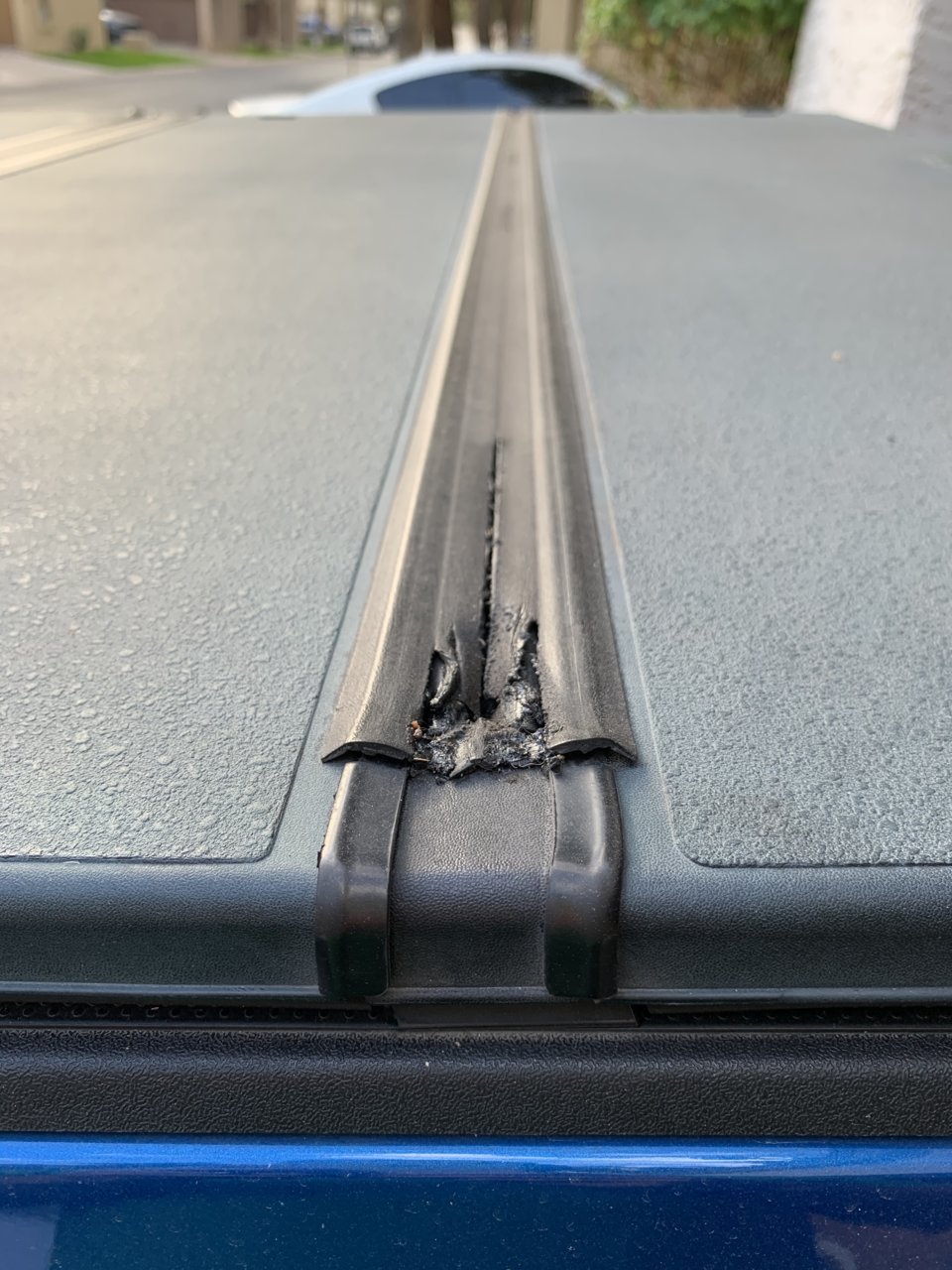

    Finally getting around to working on this.
    The front two hinge covers are part number 6497104011, and the rear single hinge cover is 6497204011.
    Not sure what the difference is, but the front ones look to be $15 a pop, while the rear one is $50.

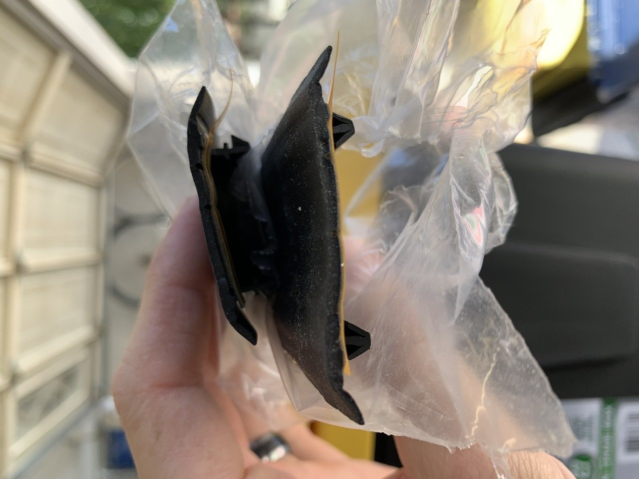

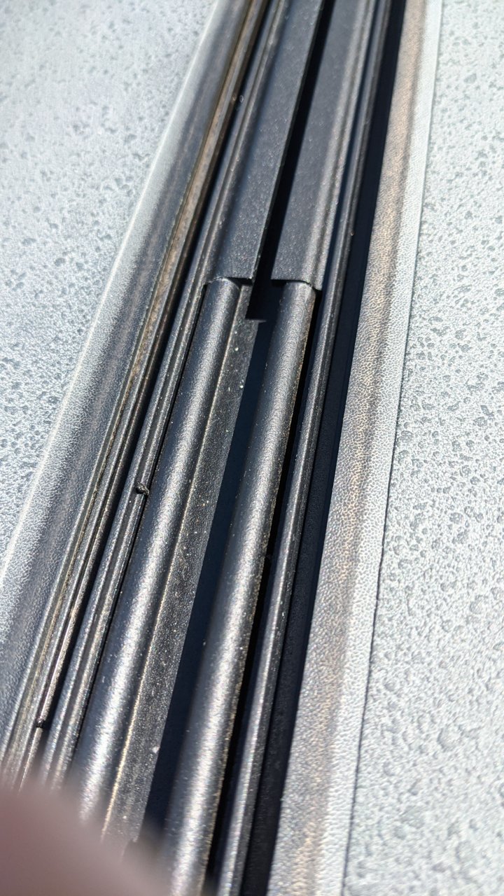

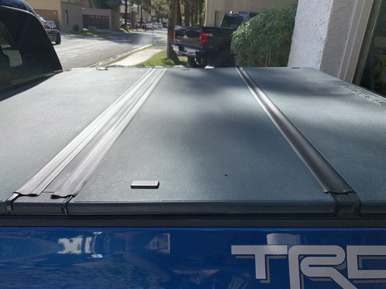

    Hey Guys I finally installed the replacement strips and took some good photos. The back strip is slightly wider so you do need it.

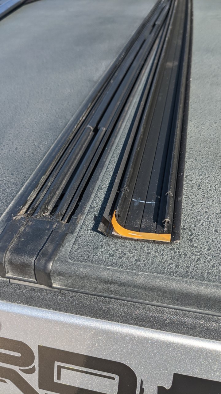

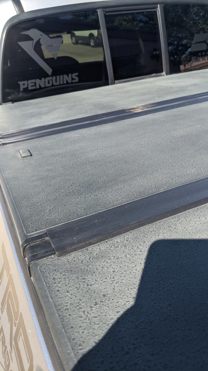

    Some photos from me,too.
    Make sure to line the notches in the seal up with the pins in the channels. The front seals are not symmetric front-to-back. :)

    Ya to @axisofoil ‘s point, take your time line everything up cause once it goes in it’s not coming back out without destroying it. I had a little trouble with one section pushing out long on one end, maybe cause it was hot but I had to trim off a little of the push in rubber to get it to lie flush. Also removal of the old stuff is a bit of a messy pain, after tearing out the strips, the V groove was stuck in the bottom so I took a razor to cut it up in order to remove the rubber left in the grooves w a mini needle nose plier. Cleaned up the tar w WD-40 and made sure it was clear before install.

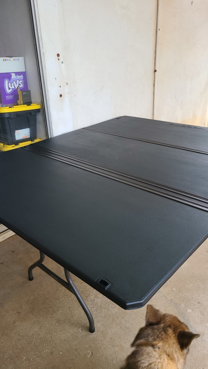

    As far as repairing sun damage on the actual tonneau cover - do you guys have a product that works well? I’ve used McGuires plastic restorer a couple of times, obviously not nearly enough.
  13. Mar 31, 2021 at 1:58 PM
    #33
    DES2009
    DES2009 Minister of Truth
    Jul 22, 2014
    #134426
    1,000,543
    Southeast Louisiana
    2017 MGM Limited
    I'm a Millionaire! One Million Posts!!
    I used the CeraKote wipes on mine... it took 7 from the pack of 10. Is it perfect? No. But it is much much better.
    Mine used to look about like the pics in @axisofoil post above. It's raining right now AND I have a busted knee, so I can't go out and take any pictures of it today.
    But I did mine about this time last year and the water still beads up like new, and it looks pretty decent.

    For that part (they were about an inch long - 95 and sunny in AZ), I installed both ends, and smoothed it down into the middle. No trim required, ended up fitting just fine. :)

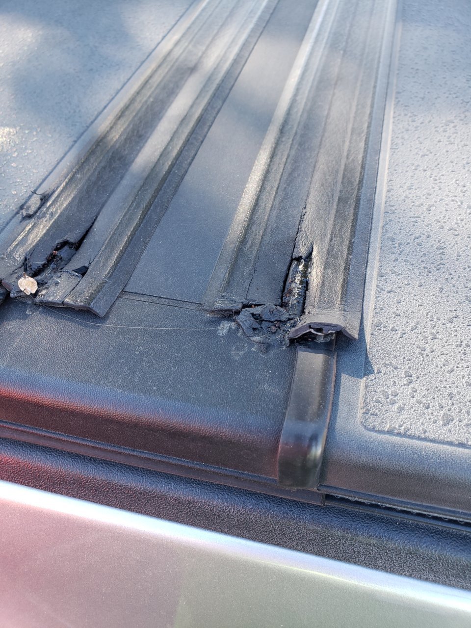

    2016 TRD OR Dcsb 4x2
    That's mine AFTER the meguiar's equivalent of cerakote. ;)
    I'll be going over it with a bunch of coats of "back to black" or similar.
