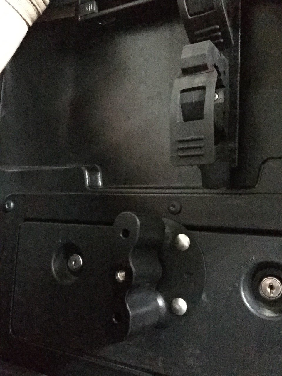

    Two gripes I have with my truck: 1) the larger bed cubby cover on the driver's side keeps coming undone and falling off, and then sliding around the bed. I keep my hitch in there, and yesterday it had opened up and the hitch was sliding around the bed as well! I'm certain the hitch bumping the cover while driving is causing the latches to open; has anyone else experienced this or found a fix?

    1) Install some cam locks. There are a few threads about it. I used some from Lowes. It is a challenge to fine ones keyed the same and will take a bit of easy Dremel work for them to fit.
    I have a 30ft strap, hitch shackle, and a spare shackle in mine with no problems. Also, if you get @micwillia 's cubbie covers, they will stay dust and water free.

    I dunno, you can see the ground through the holes where the tabs go. First time I went to the beach there was sand everywhere in there. Still I'll check out cam locks or new cubby covers.

    I installed locks on my cubby doors. Pretty easy to do. Just make sure you get keyed alike locks for all of the latches.
