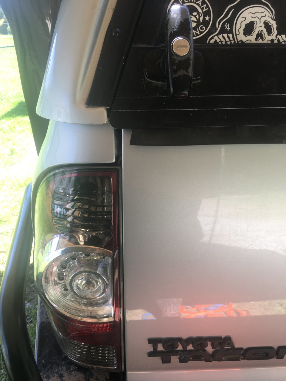

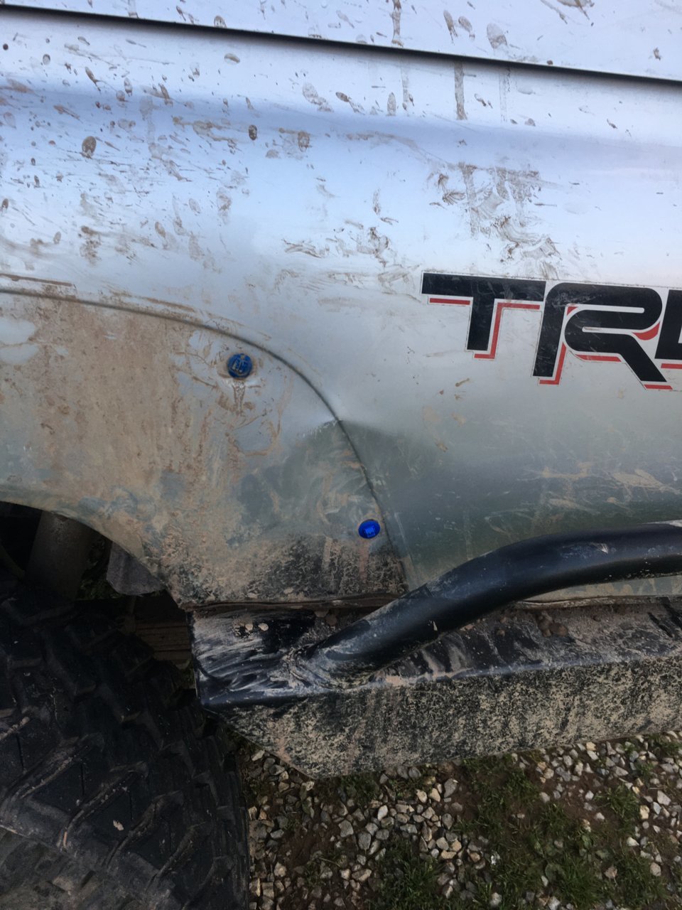

    So over the weekend I had a guy spot me pretty poorly on a line which led to a pretty good hit/damage on my end.
    I ended up taking out my stiffener and trying my best to pull the rear end back into shape but i still have a pretty good gap. Any suggestions on how to go about pulling the rest into shape would be appreciated. I don't really want to spend 1000+ on having a body shop replace the bedside.
    I was able to pull it back slightly into shape but not fully
    the tail light gap will be fixed when the new tail light arrives i hope. I broke one of the mounting pegs to it.
    side note, never letting someone spot me again for their first time ever.

    yeah which is why im not trying to spend an arm and a leg on it, but if i can fix that gap id like too. still need to touch up paint the creased section. Other than that i did a quick plastic repair on the flare and slapped her back on.

    Easy fix. Watch a bunch of PDR (pointless dent removal autocorrect says point not paint) videos go to harbor freight and get a cheap glue pull kit. If you are ambitious buy a pdr kit and go to town. My truck was all stove up and not worth th thousands it would have cost to fix the dents so I bought a couple hundred dollars worth of tools and fix them myself. I’m just going to Fuck It up again anyway so why not. I bought from A1 tools. All you need is a glue pull kit, some glue tabs, and maybe a knockdown to put it back in place. A heat gun helps keep the paint from chipping as well.
