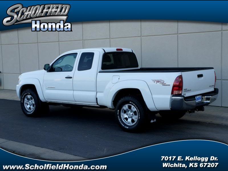

    Looking at a truck, and from the pics, the bed doesn't appear to line up with the cab. Carfax is clear, but those aren't always 100%.
    Is that a normal amount, or does the truck appear to of been wrecked to you?

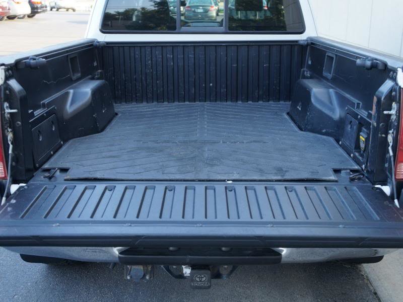

    just me- if you look at the 2nd picture (middle one), that truck looks bow legged
    if theres still doubt, bring an autobody guy with you and they can quickly tell you if any part of that truck has been repainted

    Most beds aren't lined up side to side/ katty whompass. Never seen one where the side is low like the picture you posted. I would check where the bed bolts to frame. See if composite bed brace is crushed. It could be shimmed up, if not crushed. I would look very closely at it. I can see the bed front is not even with rear window also.

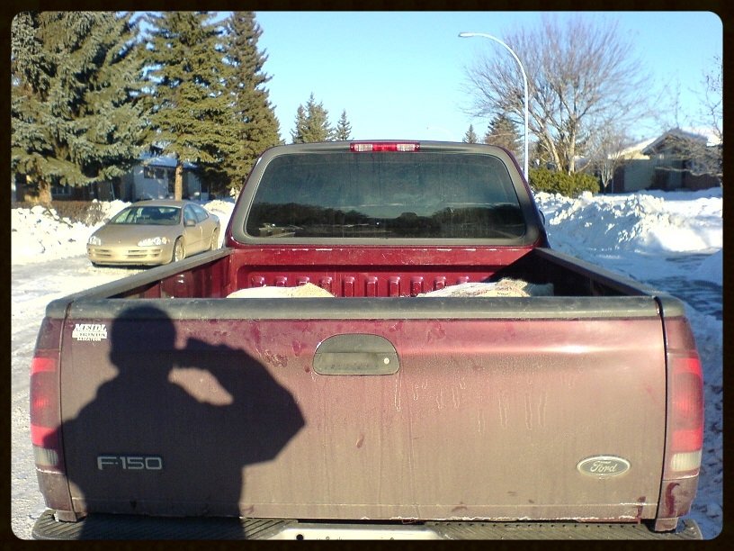

    Happened to my F150 back in 2006. I only had the truck for 2 months or so. I got rear ended by another F150 while stopped on a red light. It was a decent impact, although nothing got bent or broken at the time. I realized my bed is slanted and not aligned with the cab only days after.
    Looks like the Tacoma is worse in those pics.

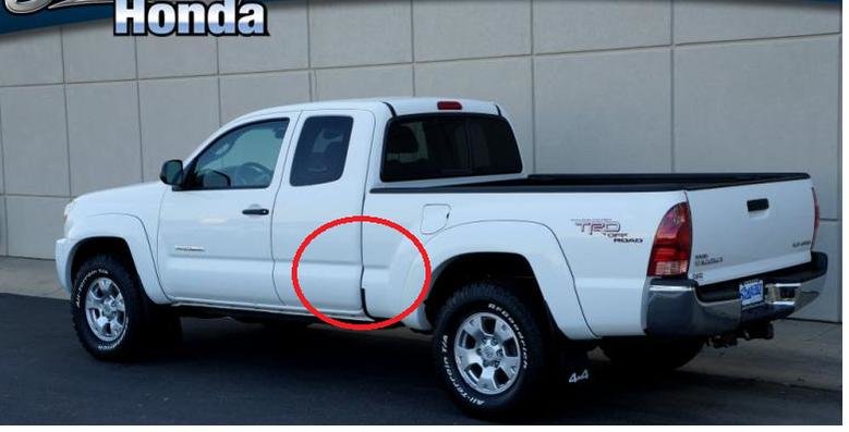

    heres what i mean OP when I mentioned that the truck looked bow legged.
    see where the cab meets the bed. those lines dont line up. the bed is lower. just my observation
