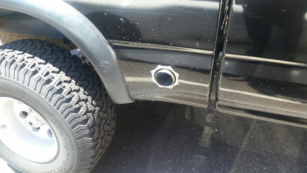

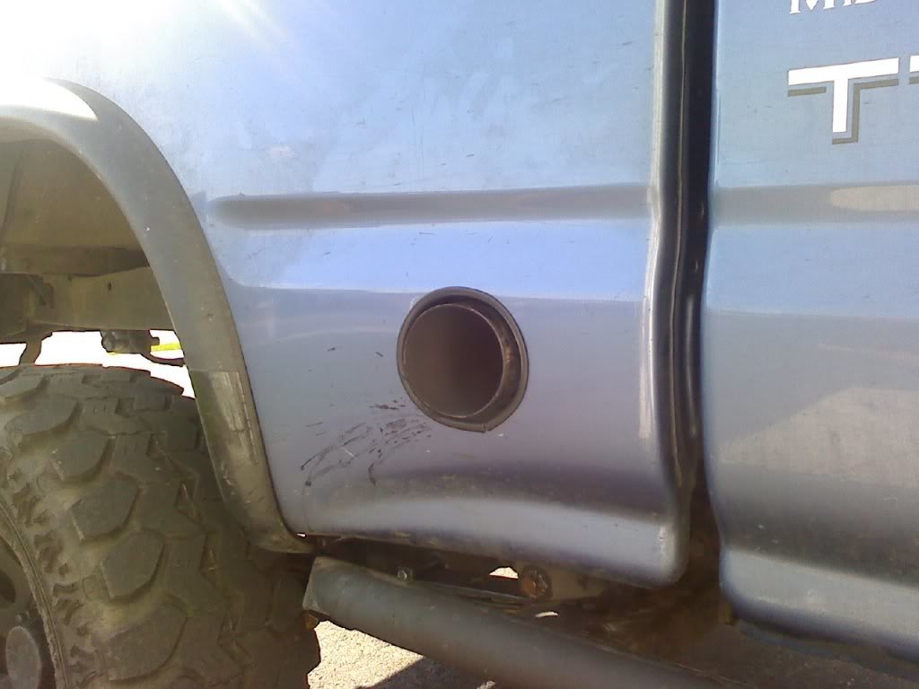

    Shop just sent me this pic. All done!! Pick her up tomorrow. Can't wait!!:yay:

    Looks good, I've always wanted to do through bed exhaust like this... Hows it sound? did you go with mandrel bend tubing or pinch bend? got any pix from under it?

    Holy crap!! Man those guys are freakin awesome. Amazing work and customer service. They went way above my expectations. They even coated the piping for me!! Asked if it'd be ok to drive for a while until I got around to painting it and he said they did that for me. Last time we discussed that he said I should be able to rattle can it myself without taking it down. So that was a surprise when he told me he coated it! Decided to tip him an extra $20. Install cost was $550.
    Anyways, she sounds sick. It's actually almost as quiet as the stock was. Even when revving it. But definitely noticeable. Can barely hear it in cab with Windows down. Haven't opened her up yet on the road yet. And the tip and trim ring is just fucking awesome. Totally worth the cost. I'll update later with pics when I get her on the lift at home. Then a vid too. Stay tuned:)

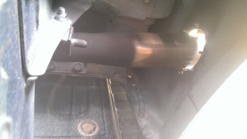

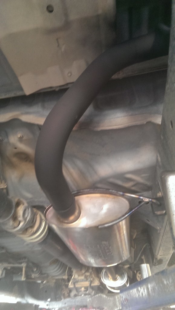

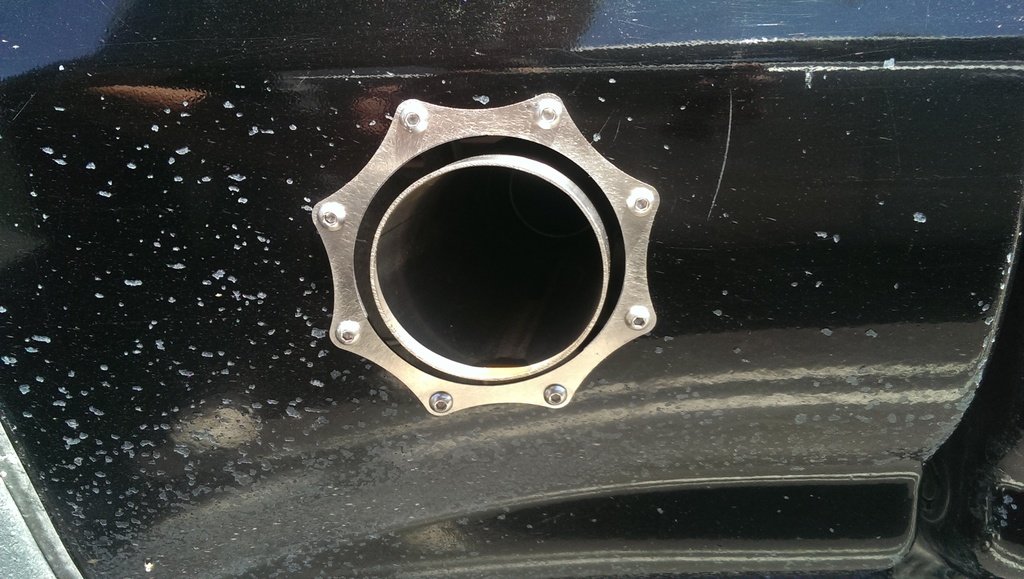

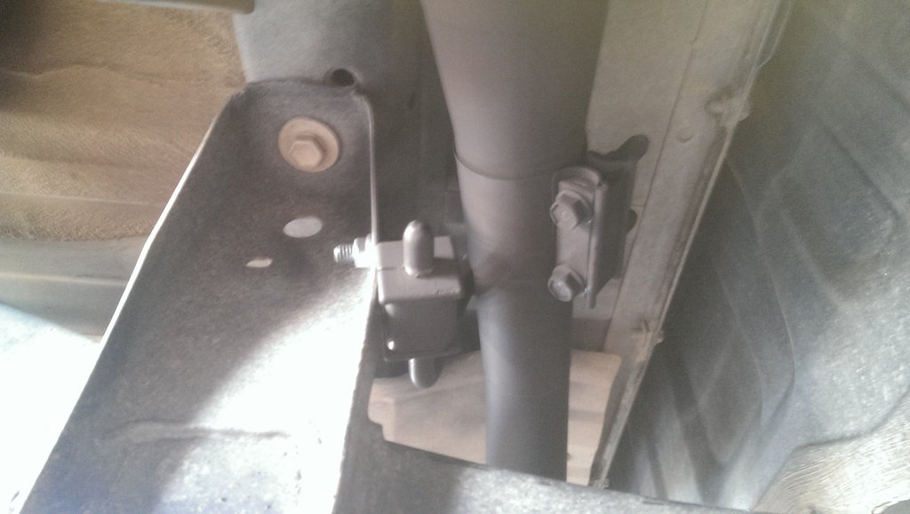

    couple more teaser shots

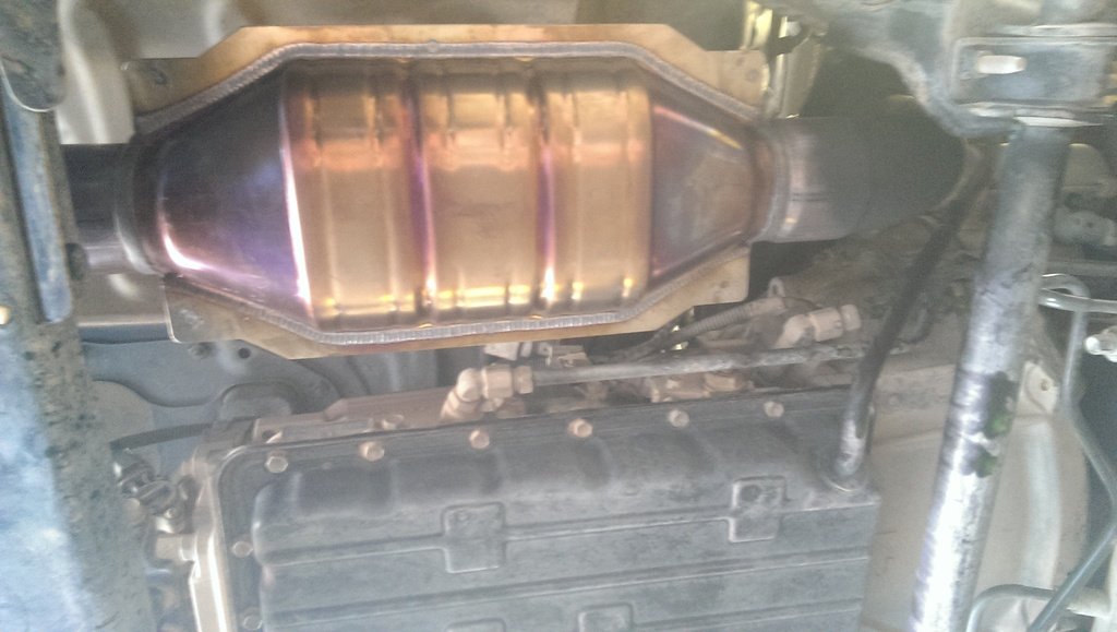

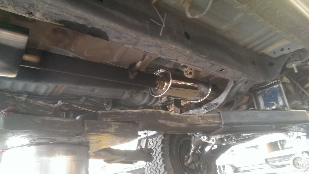

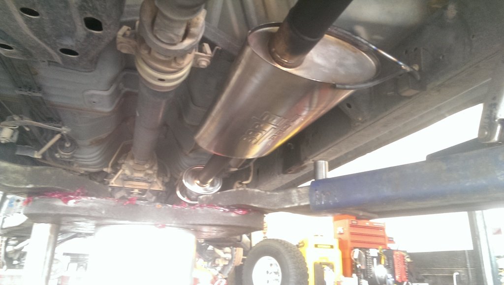

    Gettin my brakes checked. Figured I'd take a few shots underneath. Not the best pics but..
