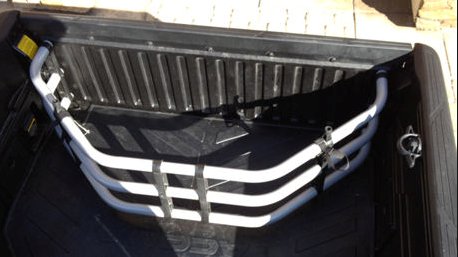

    I still have my bed ext. from my ranger and I use it at the cab end of the bed, it fits snugly between the wheel wells and with my Encore bed coverI can back flip the cover or lock it. It's like having a big trunk.

    I bought the Ford Ranger one for 75 bucks. Our Taco beds are 1.5 inches wider. The Ford bolts are 75 each, so I just ground the flats off carage bolts and drilled some holes on the ranger. Those angles might be to clear the wells when it's flipped back.

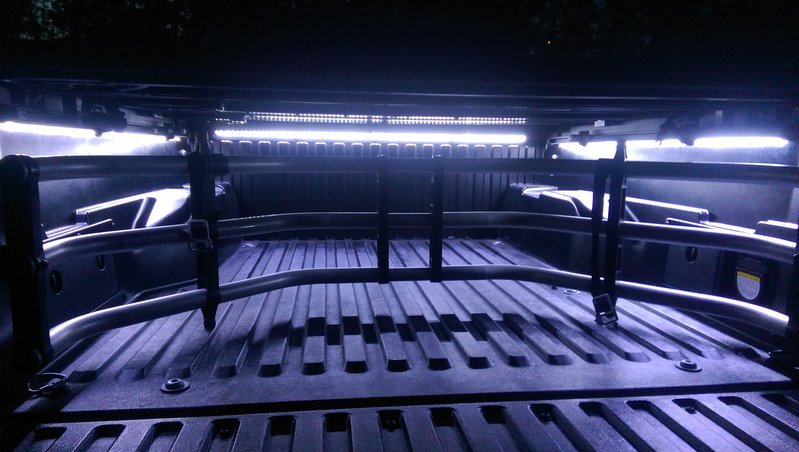

    I'd highly recommend getting the quick release mounts.
    I have these on mine which lets me pull the extender without messing with the tilt. I bought my extender so I could carry a snowblower without having to remove the tonneau cover in the winter. However, I'd be unable to tilt the extender far enough to remove it because of the snowblower. Those mounts let me pull it in and out without worry.
    I used nuts and bolts to mount mine rather than sheet metal screws.
    [​IMG]IMG_0358 by Mike M, on Flickr
