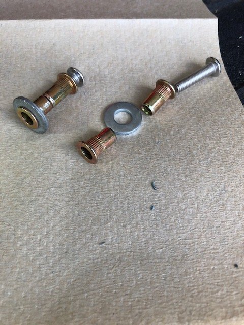

    I was able to fit a first gen Tacoma bed extender on my third gen truck.
    The Amp mounting brackets fit well.
    I had to make the bed extender latch below (it is out of stock on Amazon)
    I used a M5*20 pan head screw, a flat washer, and two M5 rivnuts per side.
    Working great for me!
    inexpensive replacement with stuff around my garage.
    just wanted to share with everyone, Thanks.
