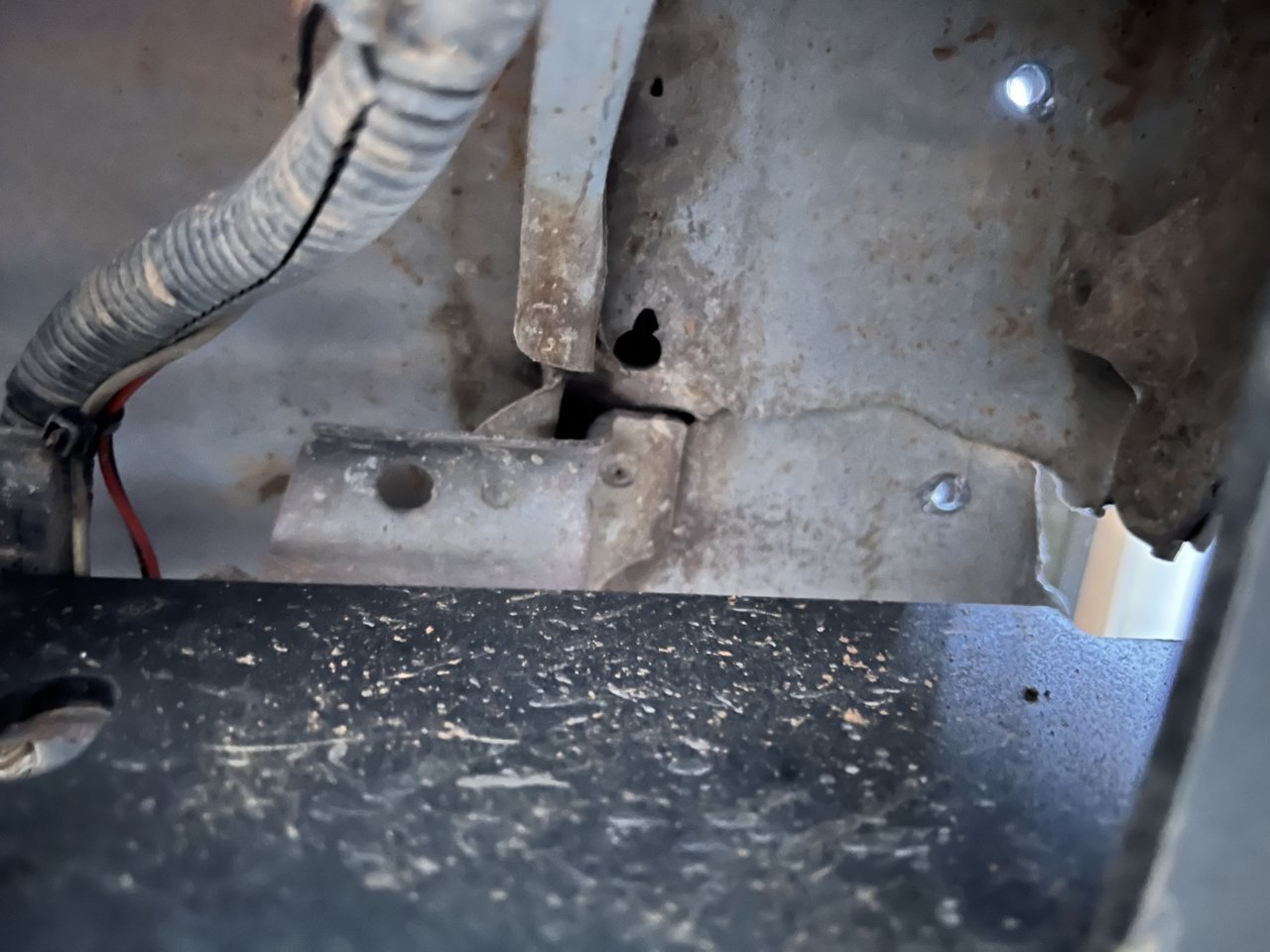

    My bed on the driver side is cracked. Won’t allow me to put my tailgate back up. It sags a lot lower. Welding a piece might keep it straight and to where I can put my tailgate back on? Any suggestions guys Hopefully it’ll close properly. I don’t want to buy a bed, I’ve been looking anyways but none in surrounding areas. I’m located in Redding ca

    Well, bottom looks like the crack went all the way through.
    Pull up that bed liner and drill a relief hole at the end of the crack to prevent it from spreading farther.
    I'm in the Central Valley and would weld that bad boy up. Would need a hand though with some clamps to pry it a bit as it's bowing inward hence you can't close up your tailgate.

    I wonder were the bed stiffeners added after the crack . As a band aid that did not work.
    Impact damage that after time just grew? Most cracks are in the Heat Effected Zone not inches from any welds.
    Winter Chemical Tacoma this is just the tip of interesting things.
    Good Luck figuring the spring back after welding.
