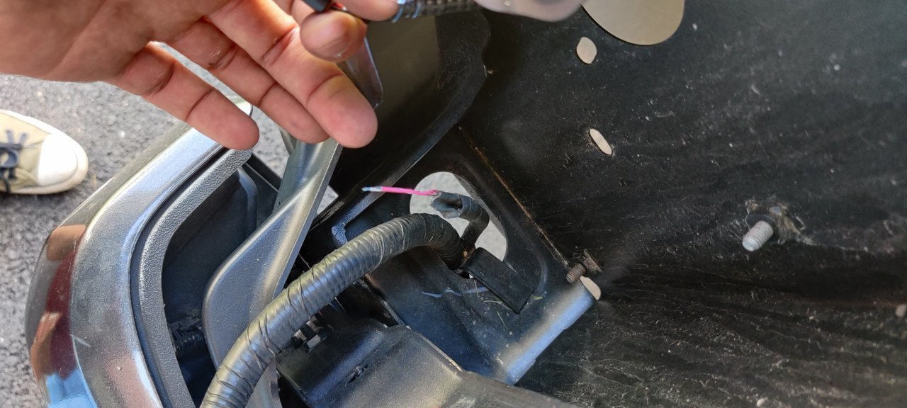

    Hey guys. I bought my 2020 Tacoma new from the dealer almost a year ago. Recently purchased the bed lights and went to install them. When I was installing them however, I ran into some issues.
    My passenger side installed fine, however my driver side seems to be missing the harness.

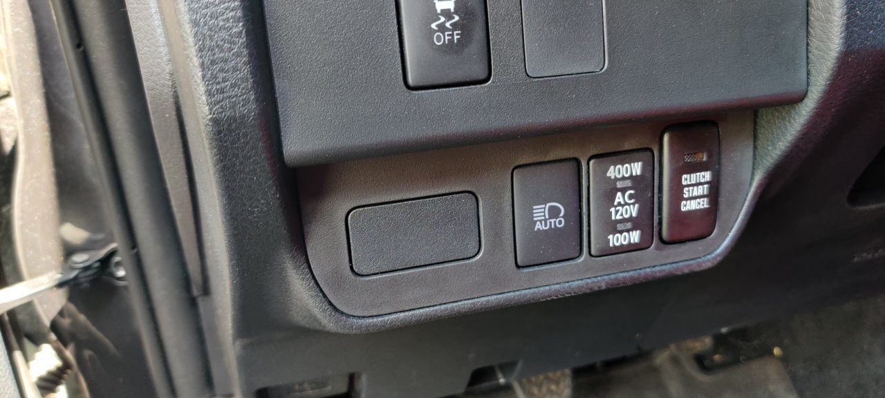

    The passenger light didn't work when I turned on my truck. I noticed that I am missing the switch that would turn it on and am assuming that is why it isn't working. If I get the switch, should all the wiring be there, or will I have to do further wiring? Is the dealer still responsible for these things or will I basically be told to go screw myself and pay for it? Thanks.

    OP pop out that black where the switch would be and see if there is any wiring. I don't think there is but there might be?

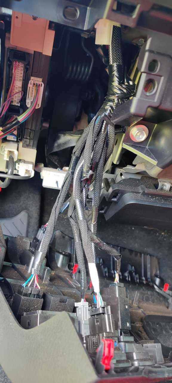

    I did find one harness that wasn't attached to anything and taped away. Is that the right one for that switch?IMG_20210616_162916.jpg IMG_20210616_162926.jpg
    EDIT:

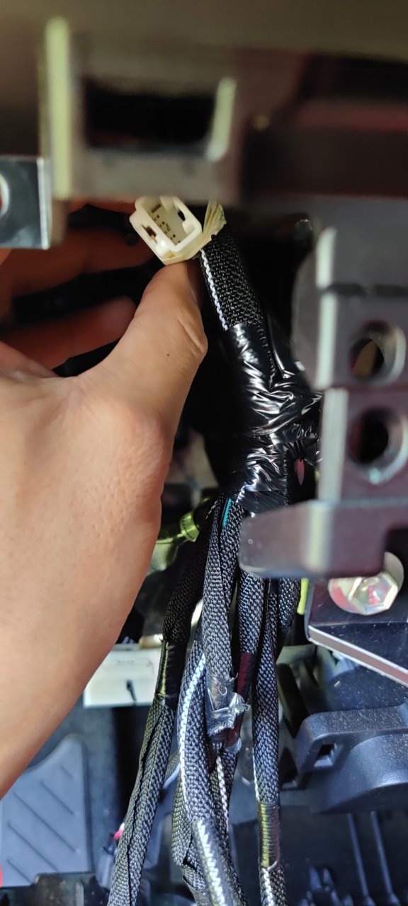

    There was also this black harness plugged into an empty space. IMG_20210616_163401.jpg

    I think that black one is it

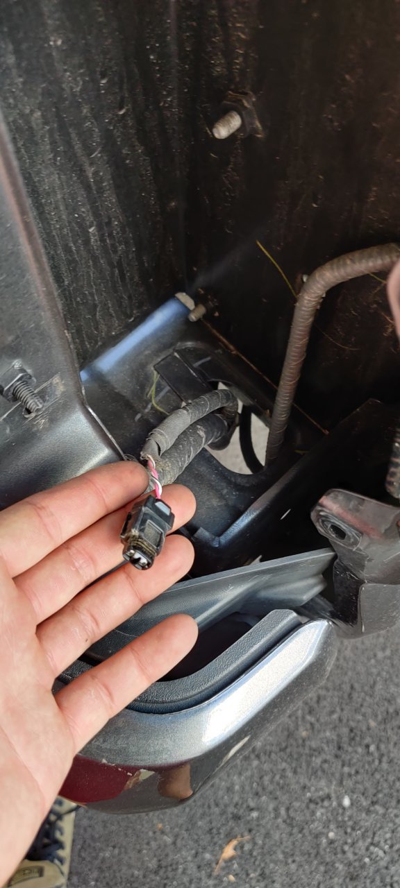

    The harness is there (the one with the pink wire) but the connector seems to have broken off. You need to get a connector and splice the wires. (This is the sort of thing you can raid a junkyard for.)

    That's what I figured. I contacted the dealer to see if they would replace it for me. In case that falls through, do you happen to know the part number?

    I don't know that the connector alone is available from Toyota. You might have to buy the whole harness from them, which is obviously more than what you need. That's why I mentioned the junkyard. Get the connector with 3-4 inches of wire attached so that you can do the splice. Probably a couple of bucks.
