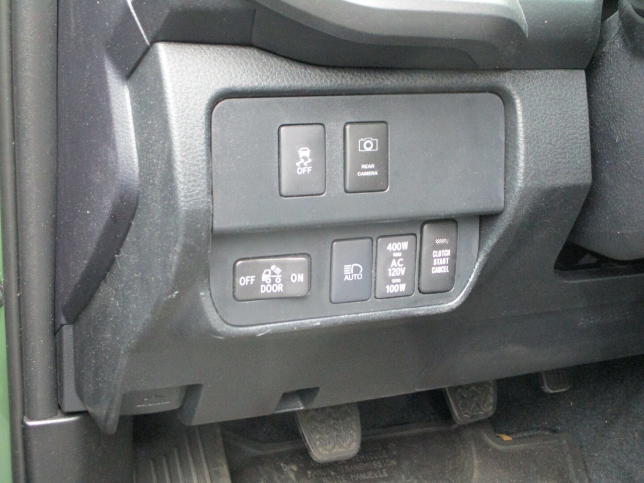

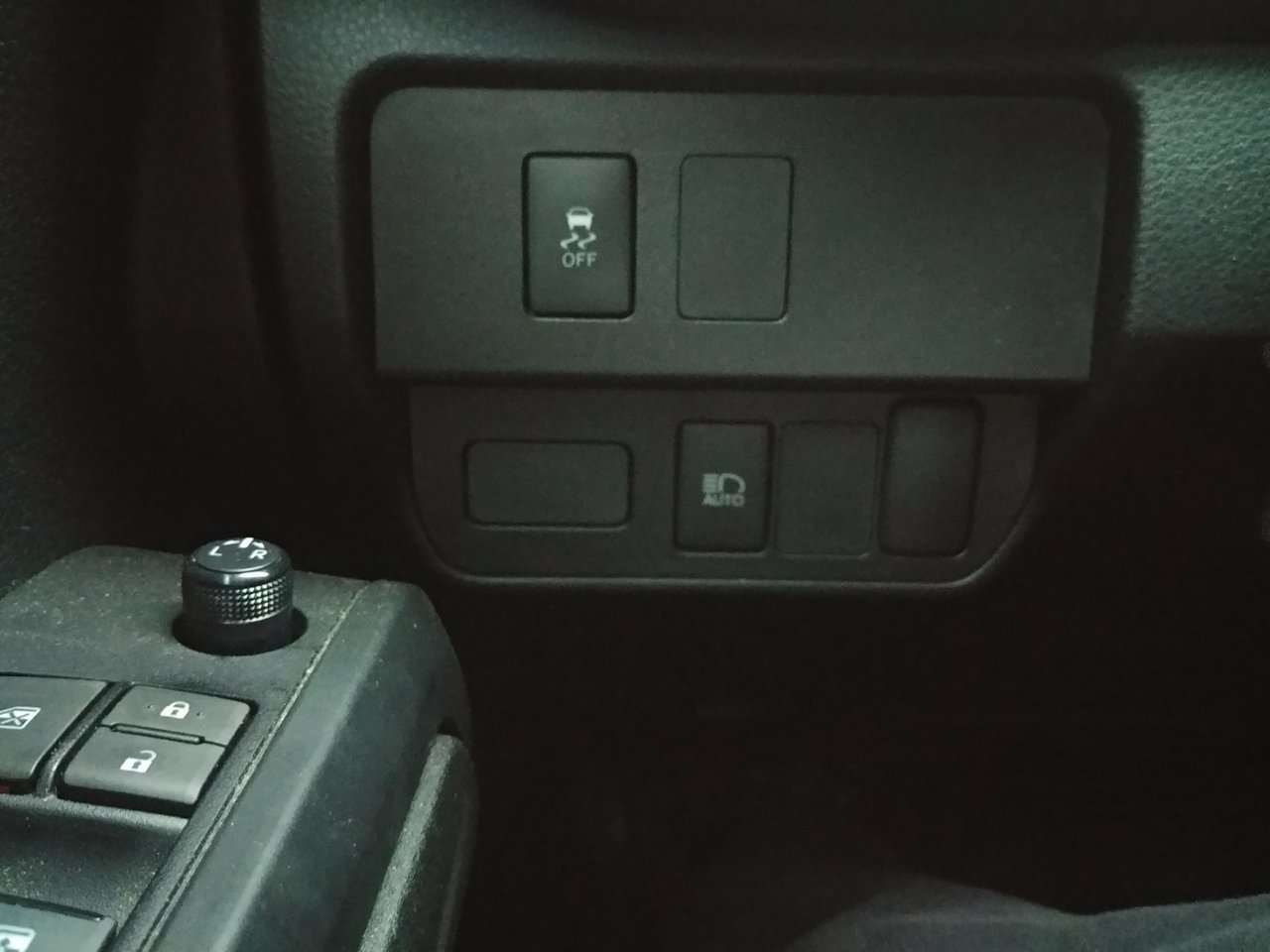

    Was wondering if a bed light kit could be added to a base model SR tacoma 2022. I have the 2 cut outs in the bed but there is no switch in the cab. Thanks !

    Pip the panels and see if it's pre-wired. There would be no switch, if it didn't come with option. Just like everyone else, you have to and switch. I would put switch back be tailgate. That the most convenient spot for it. At least mine.

    You have to pull one of the tail lights to see if the bed light harness is there. It isn't visible through the bed light opening itself. The bed light kit includes two short wire harnesses to connect to the plugs behind the tail lights.
    Trucks that have a cargo light combined with the high-mounted brake light, have the dash switch. For all others, you must add it. The switch costs nearly twice as much as the bed light kit.
