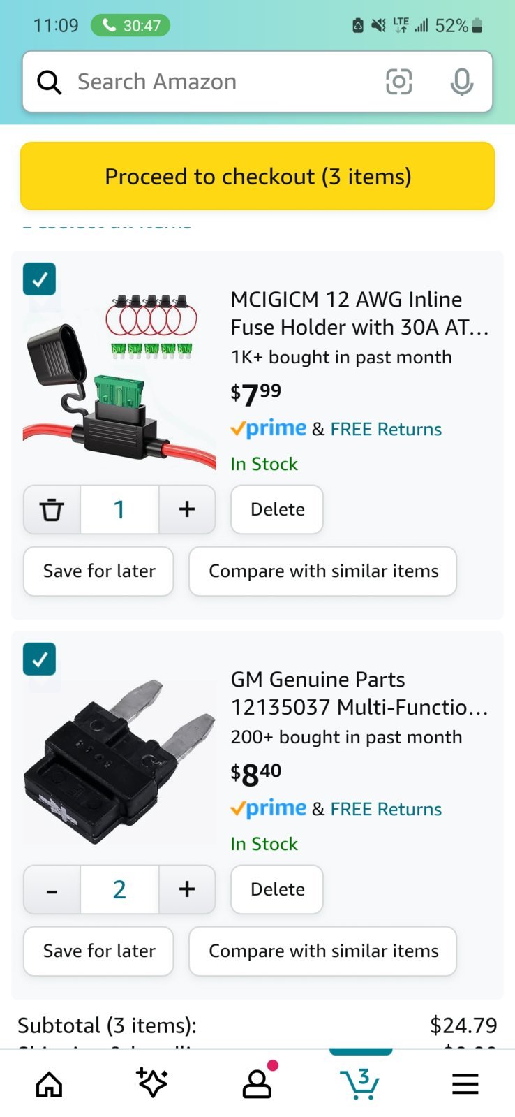

    Thank you all for the information. Sorry I didn't include this info earlier. I checked, each reverse led is rated 500ma at 12v. 1 amp total for both bulbs. I was going to make 2 seprate harnesses with 2 seprate diodes, for each side. Because the bed lights are so close to the taillight, i didn't think it would be better to run the wire across the bed. Giving the 10% room, I think it would be just under max amp draw for the stock harness for the bedlights. I was going to use a fuze style diode from gm. If this is not a good idea then I guess I'll have to run a relay. Again, thank you all very much for the advice.

    I would definitely not do 1 amp diodes given the information here.

    Exactly what I wanted but didn't wanna burn down anything, or cut into factory harness. This is one thing that will help me a lot. I found the conectors. I wanted to see and make sure I can go through with it, or if someone already has. Hopeing there's already a harness, but I couldn't find it. I did something similar with the headlights, but blew the fuse twice, so I scraped the idea. But so far, I found the bed light T harness for 1 amp from FBC, a reverse breakout from VLEDS, and a diode from Amazon. Each side will have have its own harness, with 1 amp diodes. The bulbs are .5 amp led. Do you know if it will work? I already lost a several hundred to failed ideas, I don't wanna lose the money if it won't work. Thank you for your help!

    I did some soldering last night. Went with a 3A diode, and put one on the reverse side, and one on the bed lamp side. This will prevent the bed lights from backfeeding the reverse circuit as well, just in case there are any unintended side effects. The one piece of info that would be nice to get from you would be how long of a wire do you think is needed from the bed light tap to the reverse light? And I forgot to make sure, but what year is your truck?
