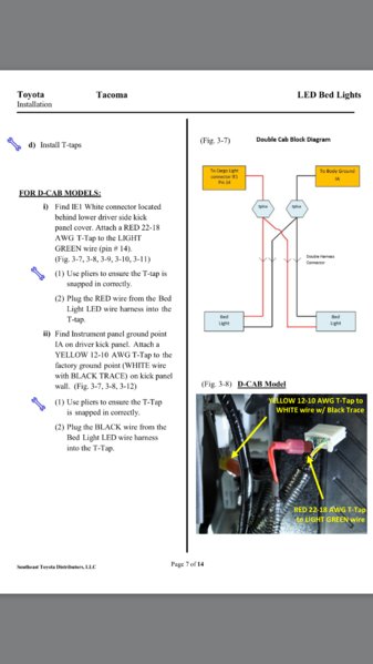

    Cool thanks. I must greatly appreciate that information and the PDF file.
