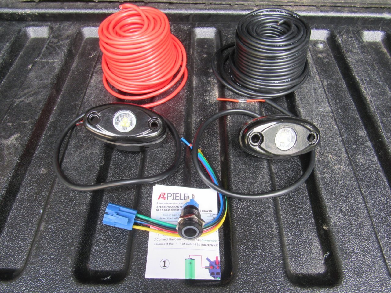

    I've seen and looked into the 'Tundra' bed lights several times but they never checked all the boxes for me. I wanted something a bit different and on a switch that was located in the bed with the lights. I sourced all of this from Amazon and it's actually cheaper than the 'OEM' version.
    Lights ($20) : You can get different colors and they are waterproof. They are in an aluminum housing, they are legit.
    https://www.amazon.com/gp/product/B01M0T8DT5/ref=ppx_yo_dt_b_asin_title_o01_s01?ie=UTF8&psc=1
    Flush mount button switch ($9) : IP65 waterproof, feels solid, and has small footprint
    https://www.amazon.com/gp/product/B07RLP1TVB/ref=ppx_yo_dt_b_asin_title_o01_s01?ie=UTF8&psc=1
    Wires ($13) : 12 gauge is overkill for this but that's my style
    https://www.amazon.com/gp/product/B07W6S8NC9/ref=ppx_yo_dt_b_asin_title_o01_s01?ie=UTF8&psc=1

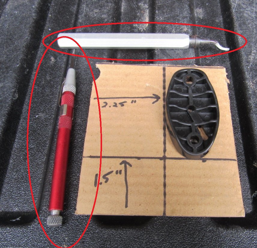

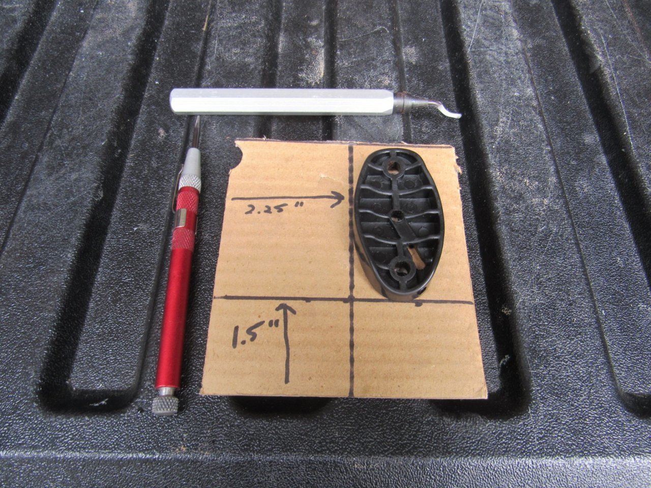

    The lights have a removable rubber backing so it's easy to make your own template with it.
    1/4 inch holes

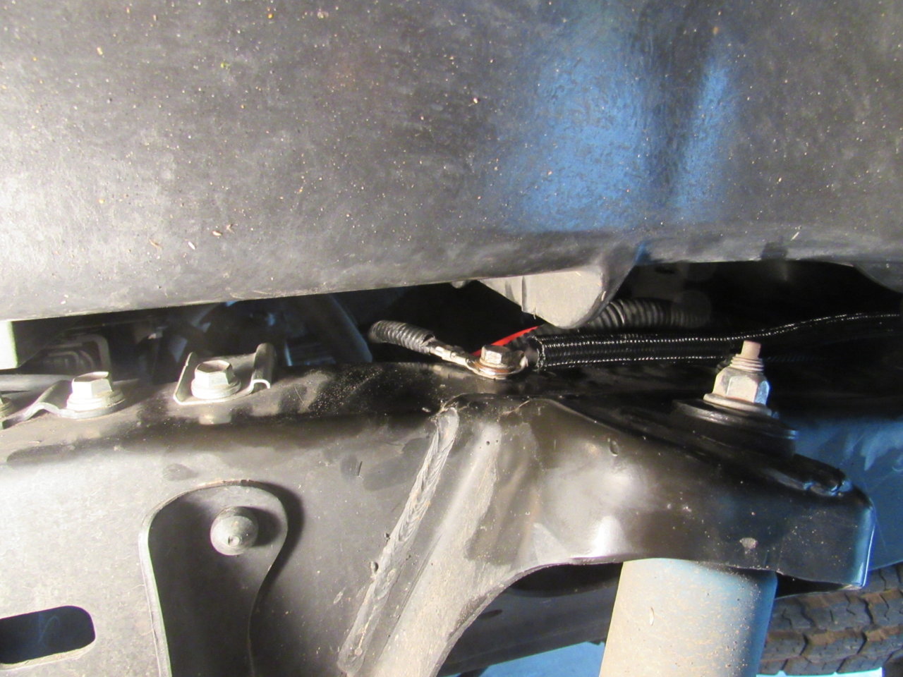

    There's already a ground on the drivers side above the rear shock - I used this. This was a good opportunity to use some emery cloth to clean up the ground point, also used dielectric grease when bolting the grounds back to the frame.

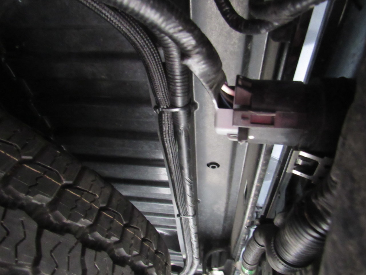

    Do yourself (and future owners) a favor and take your time running wires. With some patience and zip ties you can cleanly follow the factory wiring harness. I used some 1/2 inch wire loom on parts of the run (25ft roll on Amazon is about 15 bucks)

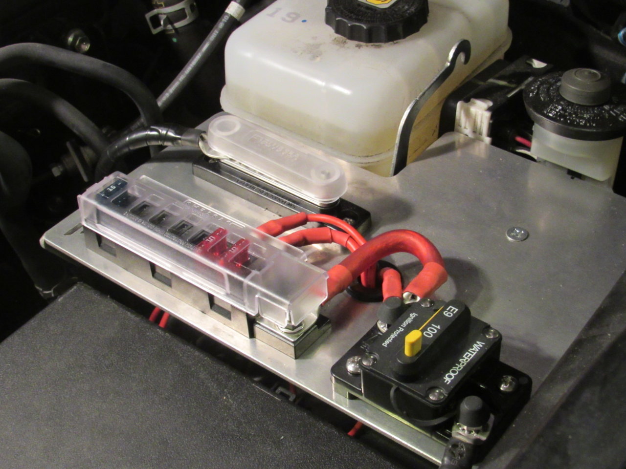

    Terminated at the fuse block. I need to get a smaller fuse for the lights, the smallest I had was a 10 amp and these lights (pair) only draw 18 watts

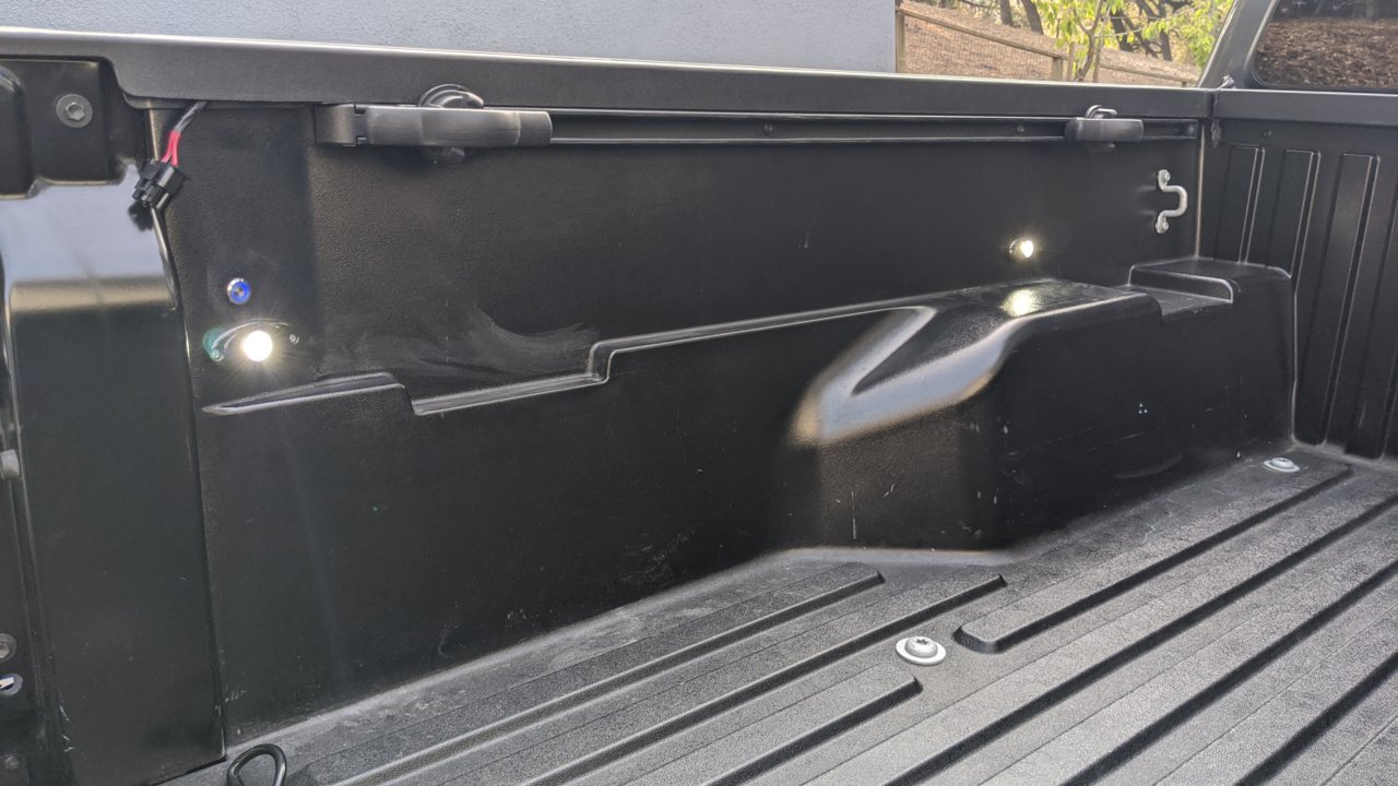

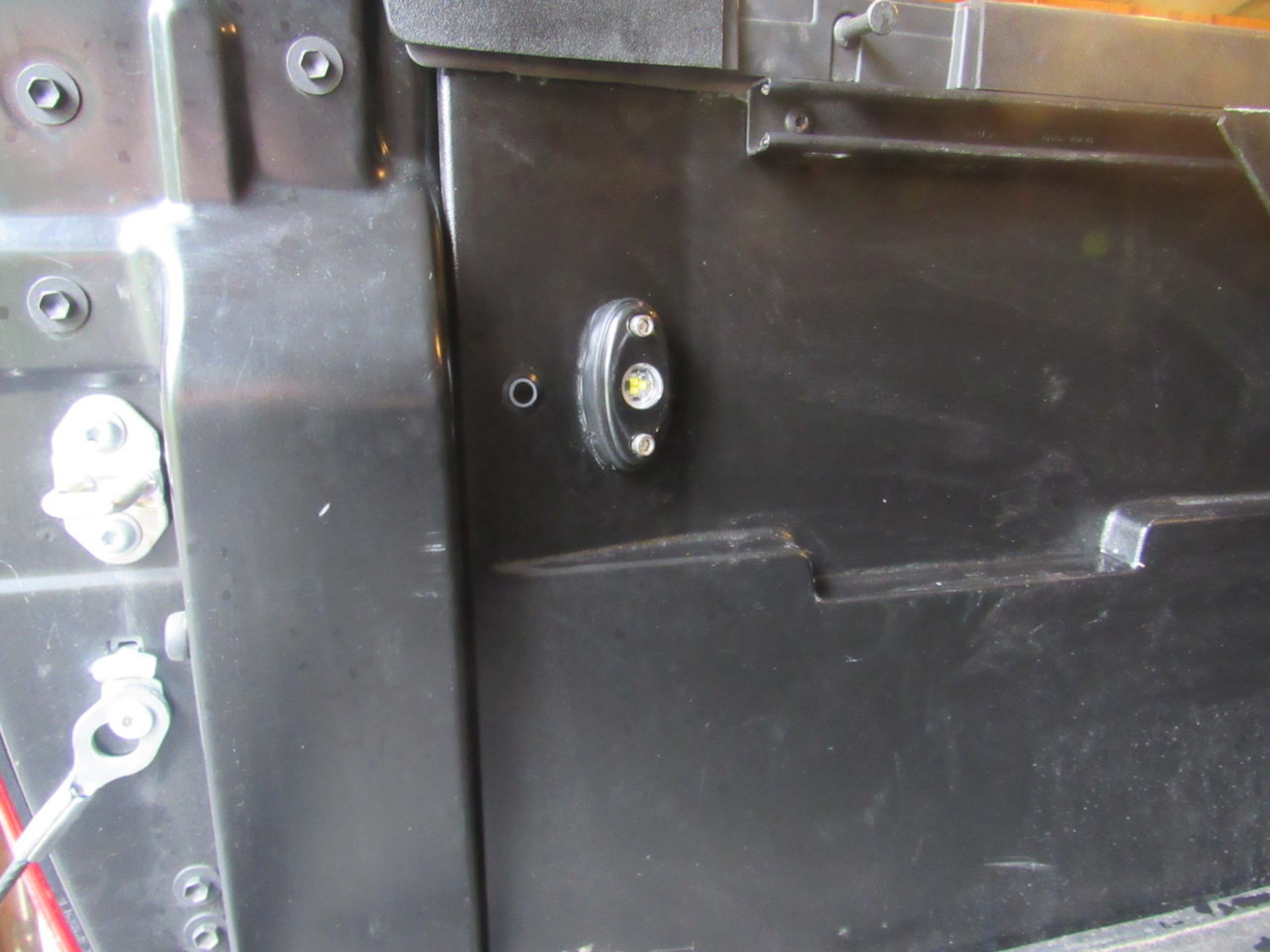

    Lights \ switch installed.

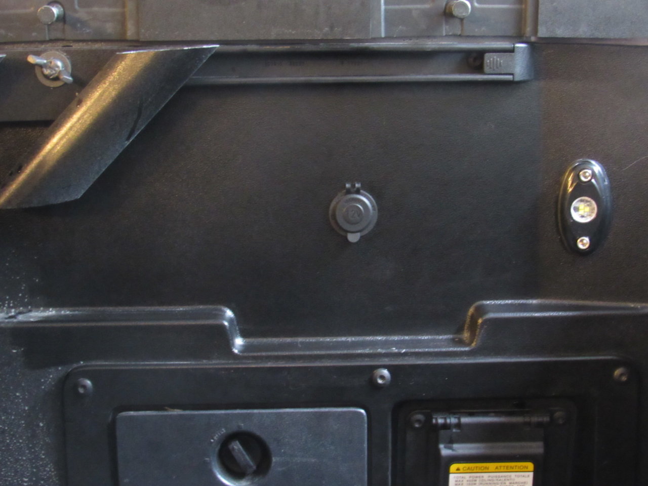

    Yeah, they are bright and light up the bed
    While you're running wires you might as well run and additional one for future needs. I wanted a 12v plug back there so I installed that as well ($10 bucks on amazon).

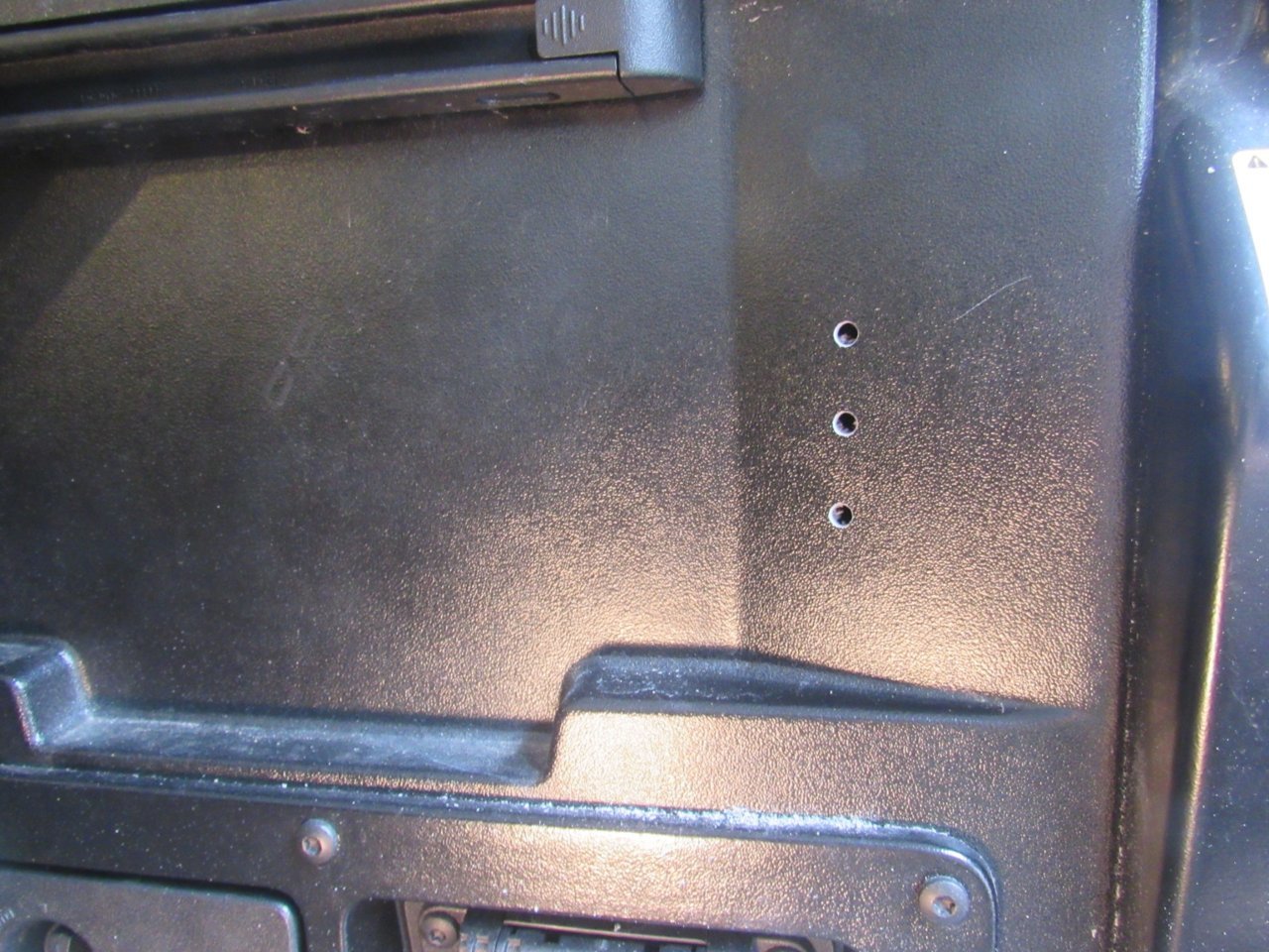

    Don't install\hole saw where I did. My OCD got the best of me by keeping it centered, however, there is a vertical bed support (fiberglass) right in this spot. Not a big deal but I'd rather not drill through that.

    Is that the switch next to your driver's side light?
    I take it that's not a stock fuse block?

    Thanks! Yes, the switch is beside that light.
    Right, not the stock fuse block. It’s a blue sea fuse block on a ‘blank’ power tray
