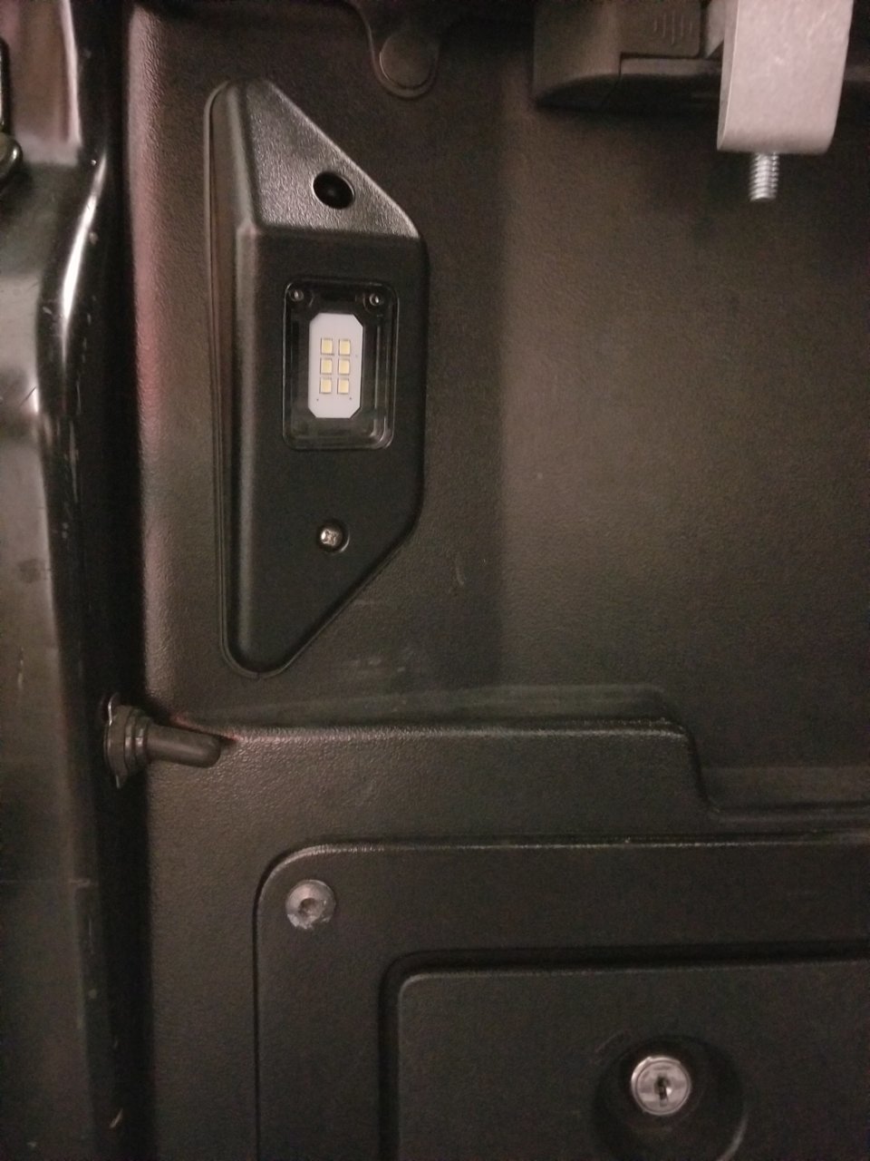

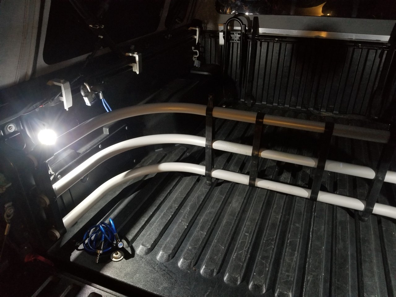

    I installed oem tundra bed lights from Amazon on my 2nd gen. It's very straightforward however the kit wanted me to tap into the interior dome light so the bed light turns on when I unlock the car or turn the dome lights on and I didn't like that so I installed a toggle switch inside the bed so I can turn it on whenever.
