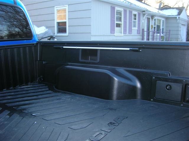

    After several attempts to load & unload my rather expensive R6 in the dark on a black bed on moonless nights, I determined I needed a cargo light. I initially used some cheap fog lamps that I had laying around, hoping that cheap meant no so bright. It didn't matter. I used some left over 3M window film tape. The double sided, sticky, but not that sticky that it will never come off sticky tape:D to temporarily locate them in the pockets. They were bright, but I could never get them to illuminate the whole bed without moving them or having them stick out of the pockets. Also they were too wickedly bright.
    So I went this route. I didn't know what exact type of lights Pierced Tiger has, but I got these off eBay for 36.98 to my door. They are protected by a 3/4" plastic tube with rubber isolation grommets every 12" or so. I can still use the factory tie-downs. They give a great glow that isn't obtrusive yet can still see clearly. It's even great for tailgating! I ran the wires through the rear access cab plug holes which are about 8" above the rear seat. I just drilled a 1/16" hold through the grommet and used a piece of bale wire to pull the wiring through. a dap of silicone and it's watertight. I then used a factory fog light switch and used the wires from the empty plug behind the dash (Probably the VSCS connector) to illuminate it. It looks so stock that a guy at work who has a 05, walked by and saw them one day and went to the dealer to see if the new 08 cargo lights retrofit into the 05's! ;) He then told me the story a few days later and was mad because I made him feel like a butt at the dealer!

    They look good! These are what I used:
    http://vminnovations.com/product/id/1166/Undercar_4_Piece_Car_LED_Neon_Kit_WHITE_%2b_REMOTE.aspx
    A little bit more than your's cost, but I couldn't find anything else that cheap. It came with 4 tubes so I just used the other 2 as rock lights. Didn't really need them, but since 4 was cheaper than any 2 I could find I rolled with it. They come in handy working at my buddy's house since he doesn't have much outdoor lighting.

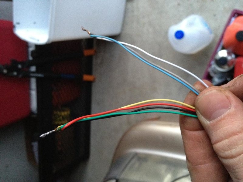

    has anyone skipped the controller, cut the wires, and hooked it all up to a switch and a ground?
    im hoping i can run direct 12vdc to these things without the controller?
    there seem to be 8 wires per tube, im assuming one ground and 7 hot wires for the different led sections?
    i think the connectors, controll box and remotes are all chincy crap in this kit. i do think some silicone around the tubes will go a long way, but they look decent. Gen 1 LED's that when lit show a Red Green and Blue together mixing into a "white" light.
    dont confuse this kit with the fancy stuff the guys are getting for more money... but i think it will more than do the job at hand

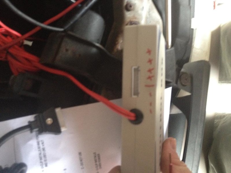

    did some cut and paste on the VM innovation lights...
    tear the connectors open and you will find 4 +12v wires, and 3 Ground side wires. the system works by sending 12v all the time down the four (green black red yellow) and controls the patterns by switching among the three grounds (blue grey white)
    Chop into all of them and send constant power and ground you will get all lights on all the time. i plan on ditching the control box, remotes and what not to allow a single switched power in, and a single ground, that way i can flip the switch whenever i want lights in the bed without much dicking around. IMG_1362[1].jpg

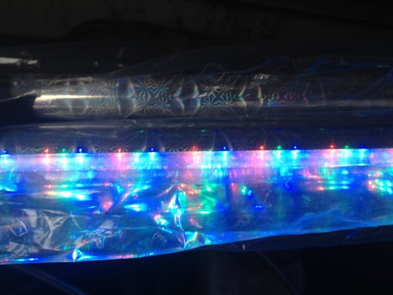

    In the bed of my truck i used the led strips:
    #40
