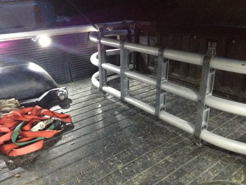

    just added a camper shell yesterday, I love it, but there's one issue. so here it is early in the morning and late at night u cant see in the bed, whats my options,? I know someone has run into this and solved it. so let me see it,i have a couple of ideas

    i bought a bed light kit from auto zone. u can wire the switch wherever u want but i ran mine in the corner of the bed. this is with a tonneau but will work with a camper just as well, unless you're looking for overhead lighting

    I'm impressed with BHP's solution, which I plan to shamelessly copy at some point...

    If you wire in bed lights,suggestion wire into your taillight circuit that way you can't forget and leave your bed lights on and get a surprise with a dead battery.There is a way to get wiring from behind your taillight through the box to wire up your lights. My 02 taco had a canopy on it sometime before I bought it and wiring was still there. I would also add another in line fuse just to be on the safe side.

    Super cheap way out, Home Depot has small stick on lights that are the size of a hockey puck and he 3 bulbs in them. push to click on, velcro back run on two AAs
    They come in black and silver. I have 3 one in the center console vault with red tail light repair tape on it and two in the bed over the wheel well
