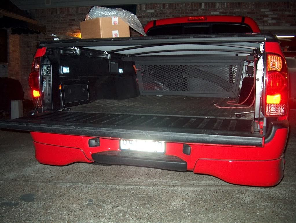

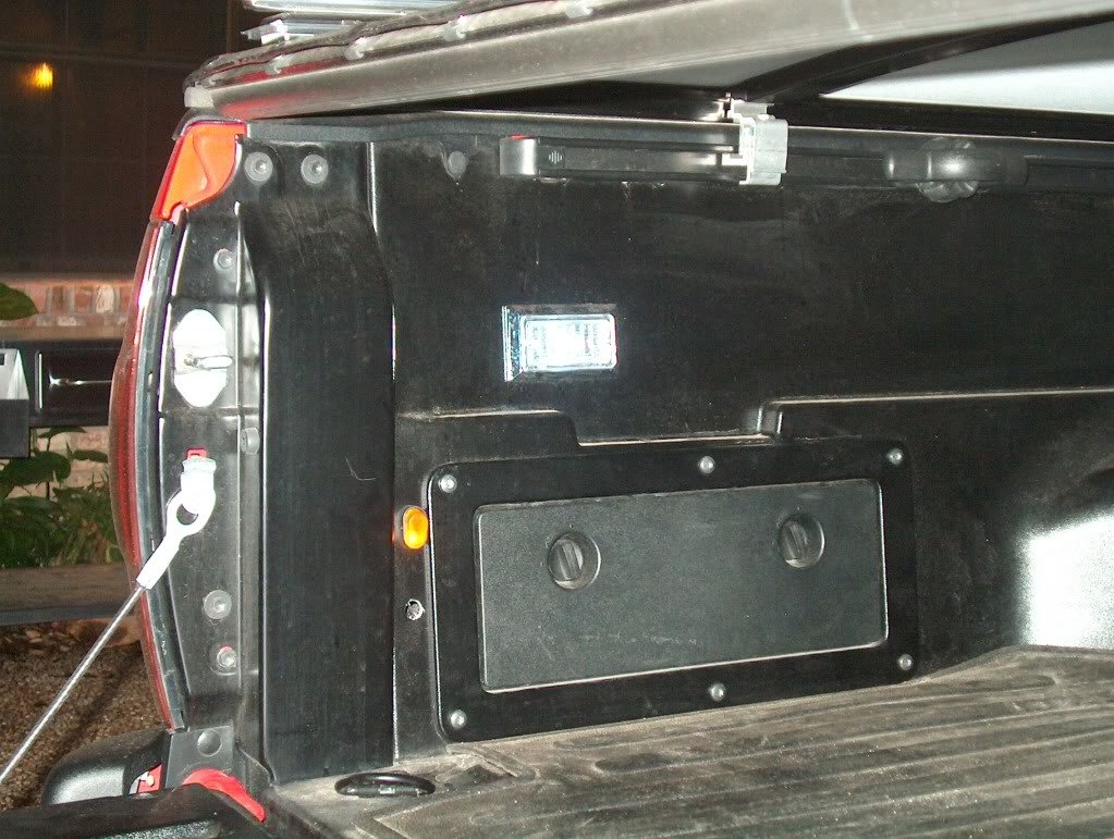

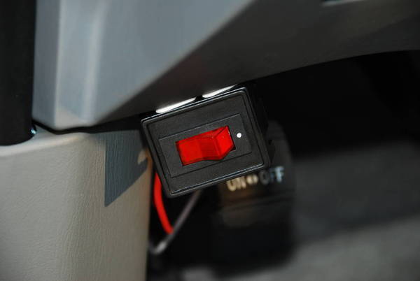

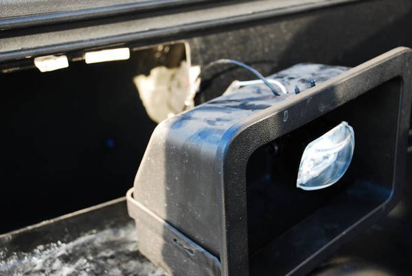

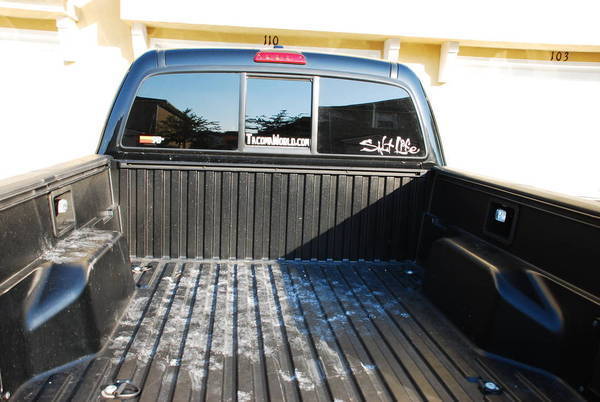

    Just got done hooking up some lights in the bed. Overall it was pretty easy, i followed a few of the step by steps that other have posted and made a few changes. All in all it costed me $25 for everything. I got the lights from walmart for $17, a wire connecter kit for $5 and a spool of 16 guage wire for another $3. Took my about an hr and a half to get everything in. And they work great! lights up the bed big time so im really happy about it.

    Lights installed:
    Switch location:
    and the wiring for the lights:
    Lights on:

    i like the location nice work... maybe to location of the switch could be more appealing! might copy ya on this one..

    yeah the switch was kinda hard to find a good location. It didnt fit in any of the pop out locations so i just stuck it there with some double sided tape till i can figure something out.

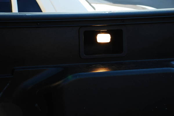

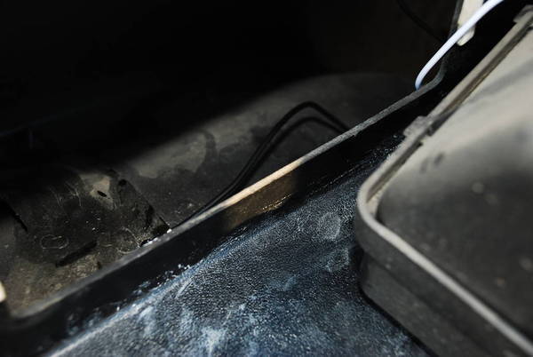

    Looks good. Here are pics of mine. I used a side marker light, replaced the bulbs with leds.
    I put a flush rocker switch close to the tail gate.

    Oh nice i like that. I wanted the switch up in the cab so i can turn it on and off in there but thats a really good idea. I might run to radio shack or something and look for a better switch.

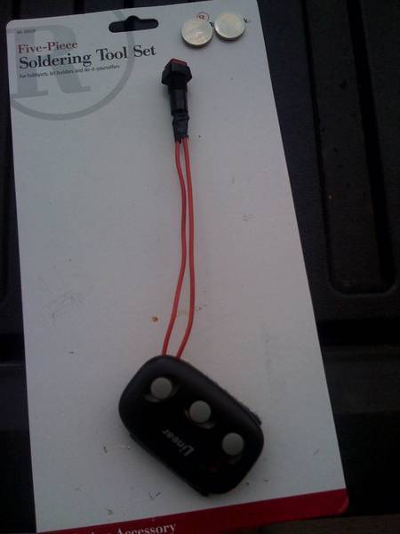

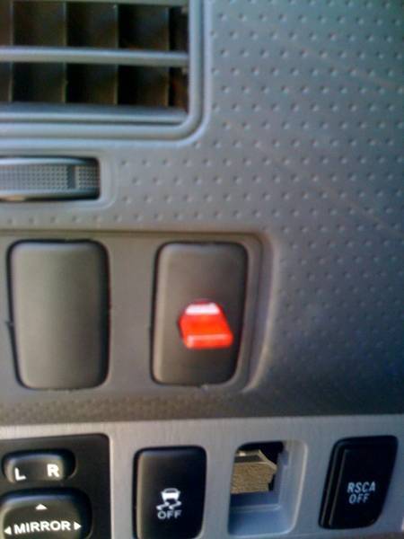

    Ok so i fixed my switch for the light. Went to radio shack and picked up a little switch for $3 and than popped out one of my blanks and wired that bad boy in. Heres the photo:
    And while i was messing around i figured i would do the garage door opener also. It was more of a pain to dremel the switch plate than anything else but about 2 hrs later i got it all set up.
    This is the momentary switch i bought:
    And after i sodered everything together:
    I will post another photo tomorrow when there is more light of the whole panel with both of the new switchs.

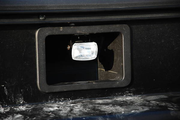

    here is my setup i did yesterday!

    Looks good Yan.
