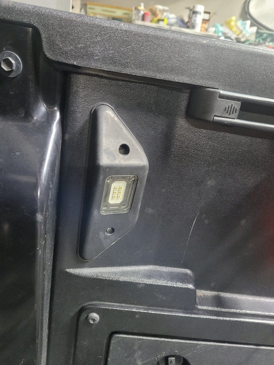

    My 2017 TRD Sport came stock with these rear cargo LED pods. My driver side recently went dark, and my passenger side only has one of two rows still working. Anyone know where and on which fuse these rear cargo LED pods located?

    It seems that the LED strips within the pods have gone bad. Both sides are powered from the same fuse and since a portion of one pod works the fuse is good.
    I believe the pods are from the Tundra. I installed a set on my 2014 a few years back.

    Thanks, road2cycle. Such a disappointment that even LEDs can be such low-end that they don't last like they should.
