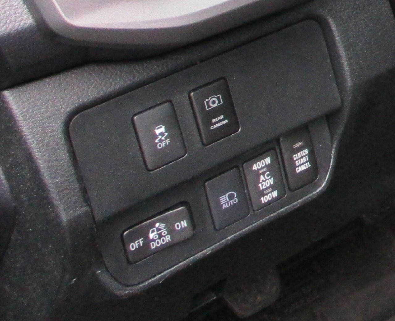

    The wiring is there for the bed lights (the lights come in a kit that's reasonably priced, and super easy to install). But for an Access Cab, you also need the dash switch. This costs as much as the lights themselves. And depending on your trim level, you may or may not need the relay that plugs into the firewall behind the dash switch.
    Here's a picture of the dash switch. It's the one at the lower left.

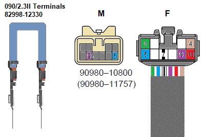

    A jumper with an On/Off switch does the job also...

    thanks for the info....is that the ground side ?
    If you jump it will they come on and off with the door with no switch?

    Yes

    i just seen another post you made..putting it here if anybody needs it..
    just jump blue and purple and lights will work with doors.

    took the Taillights out..plugged them up...got some pin terminals here at work,made a jumper to connect the blue #5 to purple #9 and boom they was lit

    Thanks for the info but which plug and where is the plug that needs to be jumped.
    Edit: I dug a little deeper and it's the plug behind the panel where the on and off switch is supposed to go.
