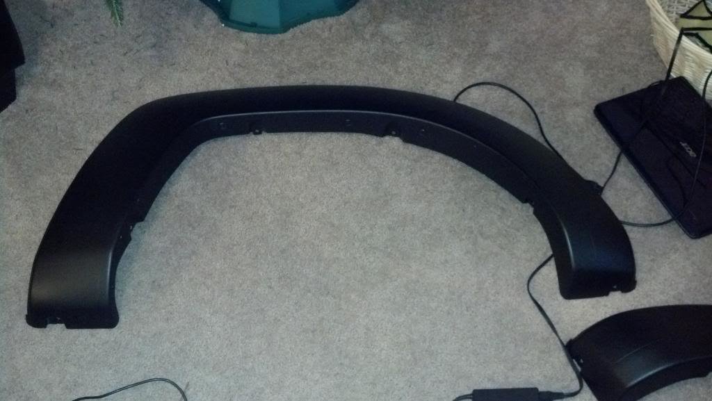

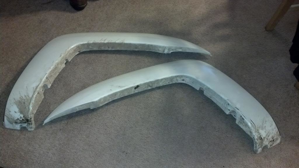

    So I am officially tired of the all super white truck. As part of my mods I decided to do the fender flares and grill with bed liner. I will do a post of my grill later.

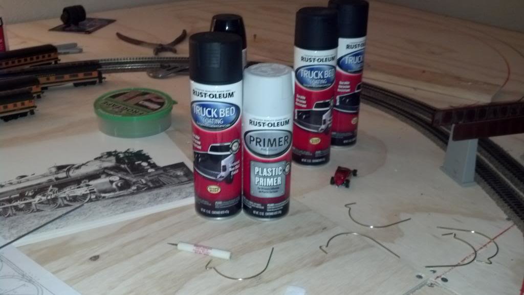

    Products needed:
    4 cans of rustoleom bed liner
    2 cans of rustoleom plastic primer
    80 grit sand parper

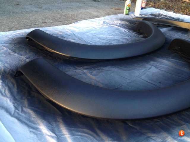

    The first thing we all know to successful painting is the prep. I washed all my parts with hot soapy water. Once dry I scuffed up the paint with 80 grit so the primer could bite. I sprayed 3 coats of the plastic primer while letting it sit 20-30 min. between coats.
    Next I sprayed the bed liner and used 2 coats with a dry time of 2-5 min. I let final coat dry over night. And here is the final product. Looks a lot like the stock black fenders.
    I still need to get some new fender clips and then I will post pictures on the truck.

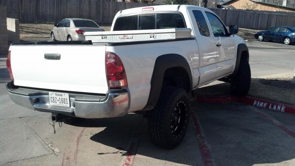

    I am finally getting around to installing them!:cool: they look great and so far they have held up to spilled gasoline, slight mudding, and pressure washer. take a look... Thinking about doing the bumper flares and the fuel door next. FYI I went to a dealer to get a quote for the flare clips and it came out to be $154...:mad:
    so I went online and bought way too many of both sizes for $10 free shipping.:D

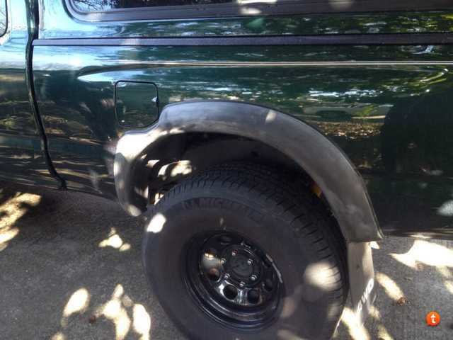

    I started to prep for doing the bedliner today. I started by using magic eraser to clean all the junk off my fender flares. [​IMG][​IMG][​IMG][​IMG]
    As you can see, the results were pretty dramatic. Now I'm not sure what I want to do. I haven't had to remove them at all, and they look great now, but I'm afraid they won't last. I'm also thinking about using "forever black "or this other stuff I saw today at AutoZone [​IMG]. Any thoughts regarding this?

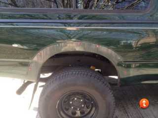

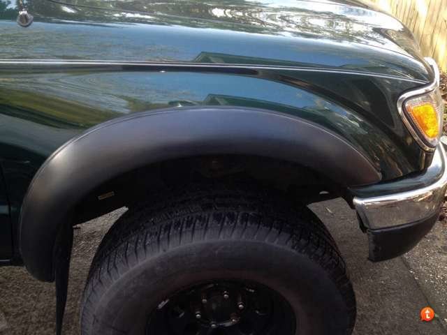

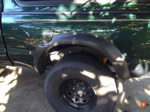

    So here's an update on my fender flare project:
    Tried the rustoleum paint, and boy did it SUCK! It was streaky and looked like overall garbage. So I went ahead and pulled all the fenders off...
    Managed to break every single plastic clip. I mean scorched earth. Not a single one stood a chance :) I cleaned them with rustoleum tar and way remover, sanded, and cleaned with mineral spirits. Then a coat of rustoleum plastic primer and a few coats of the same rustoleum bed liner as the OP.
    They are looking gooood! I am going to do the plastic on my bumper valence too, I'll post some pics of how that goes. I ordered some clips off of Amazon for a total of 15 bucks, they should be here by Friday, so I'm hoping to have this tacoma all back together soon!

    I went on trails today with a bit tighter clearances than I would have liked but it put the bumpers and flares through the tree branch scrape test.
    An I am pleased to say that there are only those dirt looking scratches. I was quit worried when I saw all the lines and scratches but I wiped one fended and part of my bumper off with a wet rag and it is back to new. I am not sure about the texture but I think it will grow on me.
