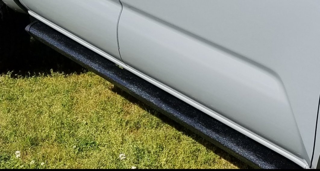

    I've used spray Rustolum before. Light sanding and alcohol wipe down of the powder coat to prep. If they are uncoated, use an etching primer. East to touch up when necessary. I coated the fenders on my wife's JK with Line-X about three years ago, that are just as clean as they were the day I put it back together. Line-X has good UV stability and is very durable. Prices vary between Line-X guys.
