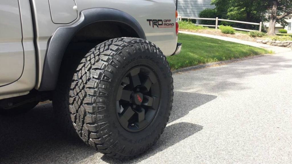

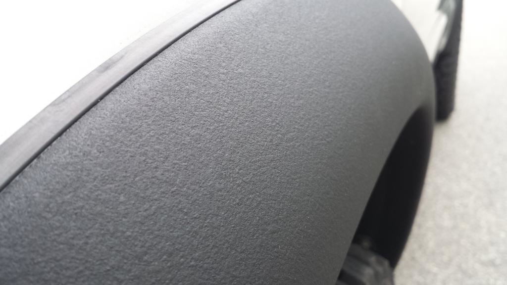

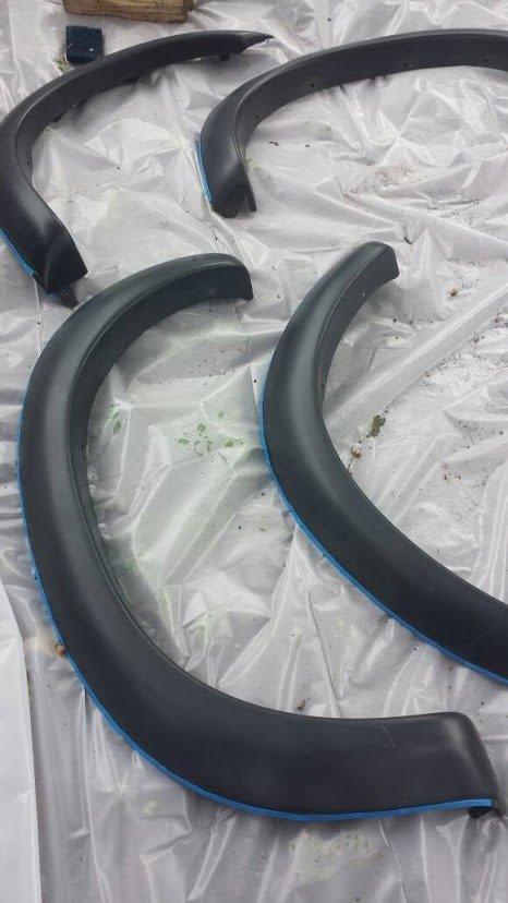

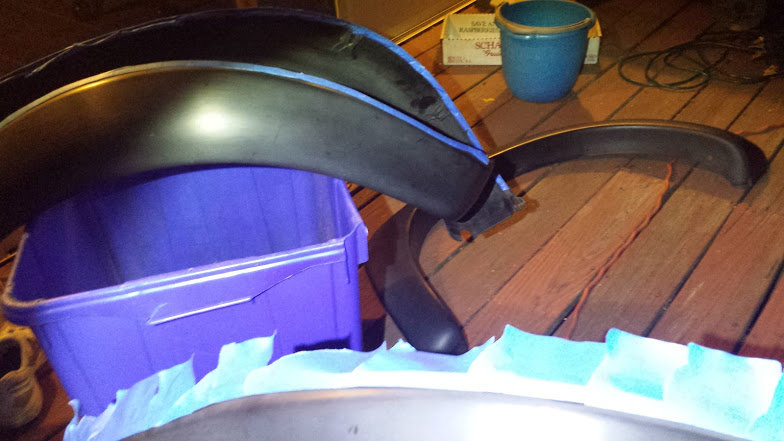

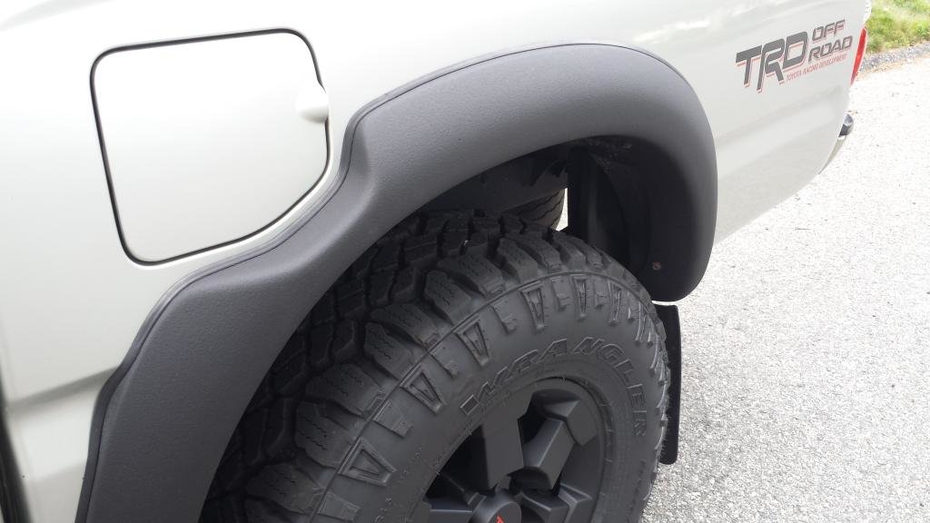

    So my flares are done. Bed lined with duplicolor bed armor in a rattle can. Removed the flares, delicately taped the rubber trim, cleaned the plastic, scuffed with 150 grit sand paper and cleaned again. Base coat of a flat black plastic bonding paint followed by 4-5 coats of the bed liner (about 2 rattle cans)
    Figured it'd be nice to see more pictures by another user :)
    before:
    after paint:
    MuddyBeaver and DustStorm4x4 like this.

    That looks really good! Guess I have a new project...
    I did pick up some of that "new" ArmorAll trim stuff that I will try first, but I am not too optimistic.

    Beautiful! You did a better job than I did - no doubt.
