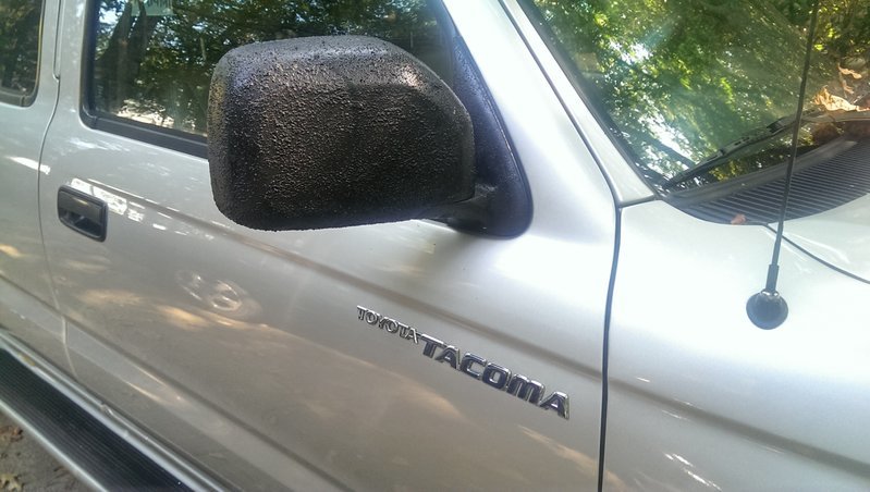

    Sorry it took so long, here is the mirror completed.

    Cool. I heard bad things about the spray on, so I went with the brush on. It may have dried in the can since I used it meaning I wasted $30 though. I did like that I could change the texture, as I used less on the mirrors. Also, I didn't want to take them off so brush on was pretty much the only option. Just sand them until they are rough as pictured, the spray on certainly wouldn't stick otherwise. I also recommend taping off the rubber gasket, as they don't need to be covered and they could cause problems.

    I think I regret doing the mirrors. They do match the fenders, however look a bit tacky and are hard to clean. I wouldn't recommend doing them unless you just absolutely love how they look. The only reason I did is because I couldnt seem to keep the stock plastic black.
