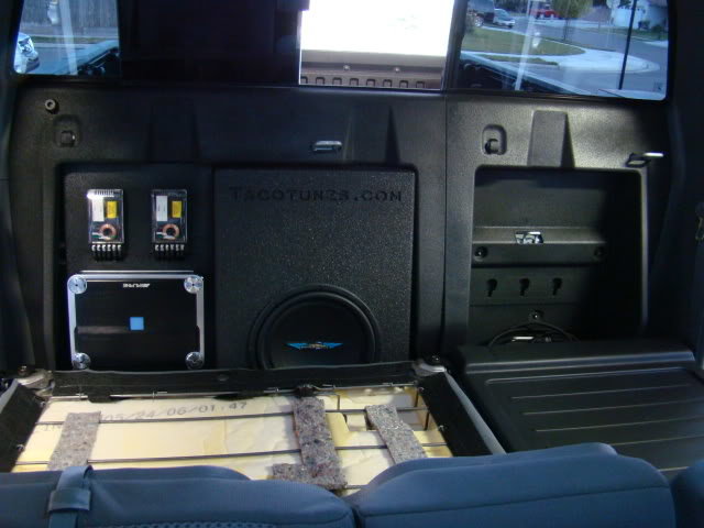

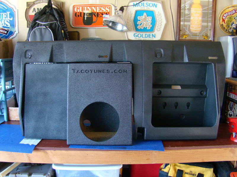

    I recently did this to an amp board I made and attached to a box that was already lined with "Line-X" brand liner. The "plasti-kote" canned bedliner didn't match well or have the same texture.
    So I added a couple coats of rubberized undercoating to give it a thicker look. Let that dry for about a day. And then did about 3 coats of the canned bedliner. I then finished it up with an enamel black spray paint to give it a perfect match.
    Here are the 2 products I used...
    ...and finished look. I also did the same process to the plastic storage bins. Came out really nice.
