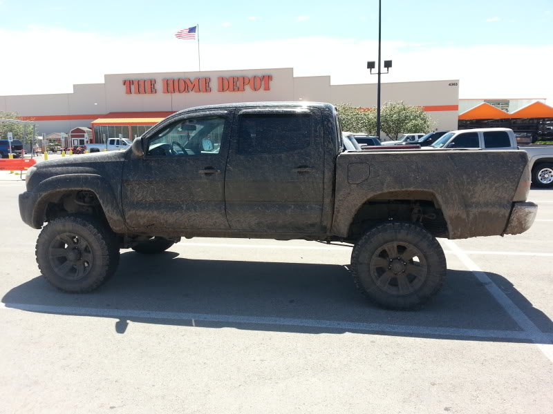

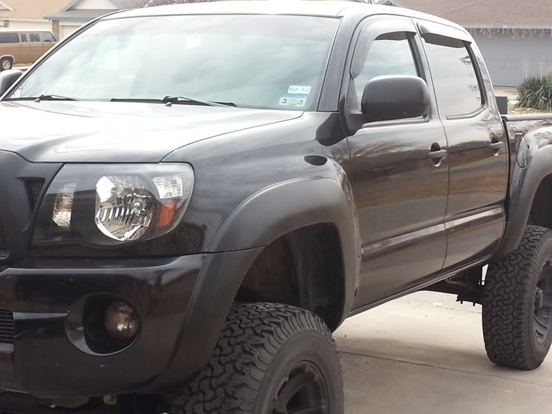

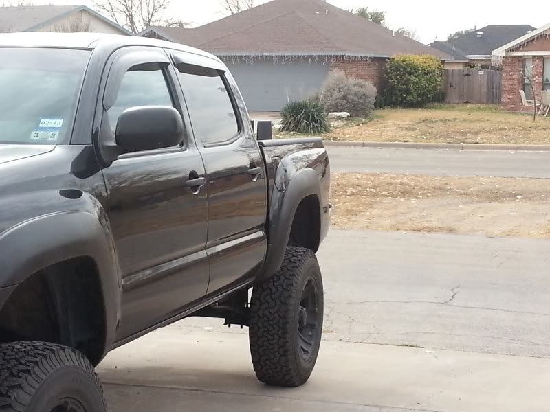

    I just did the fender flares and mouldings on the bumper cover. I used the 3M bedliner from WalMart with a roller. I tried the spray can, and that went on like crap. Use the roller. Just wash and prep it correctly and it goes fine. Use Blue painters tape and it takes a few coats to get it thick enough to look right.
    I'll find pics

    Looks great! Gives me a really good idea of what it will look like on the front cover and flares for my BSP double cab. That first pic is exactly the one I was trying to find or something close to it.
