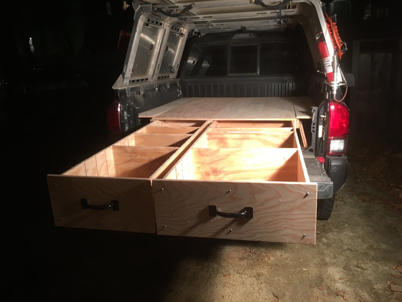

    sorry about the off topic question, are you using sliders? Or how does the box slide out? Very interested in doing something similar, I’ve been wanting something simple like yours.

    I didn’t use sliders for two reasons: one of which was cost either in money to buy or time to fabricate or source. I started building them a week before a 3 week trip to Mexico and just needed something to help stay organized.
    The other reason was that I could imagine having to open them on a forward/rearward incline and I wanted some friction to keep the drawers from rolling open or shut while trying to get something in or out. Add to that some kind of recovery situation and it would be pretty frustrating.
    So, I just built the drawers with 1/8” clearance on all sides and waxed the bottom of the boxes to add lubricity. I think it was a good choice.
